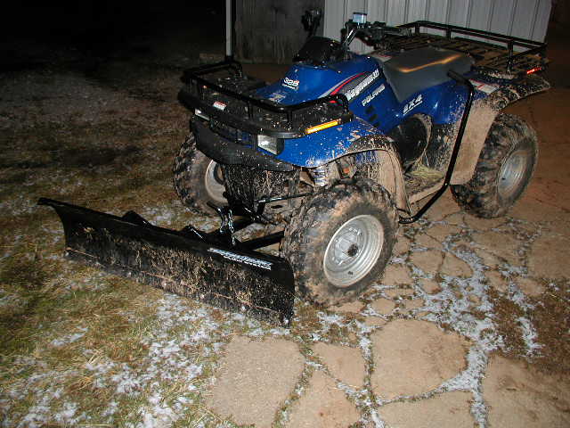

This year Santa brought me a snow plow for my Polaris 325 Magnum 2X4. I needed it not really for home use but to use at our church. It will be a lot easier to haul down than the Kubota L3130. It is a polaris blade so the install was pretty easy. The brackets all mounted to exhisting holes in the frame. It took me about 3 hours to get the job done. We do not have any snow on the ground so I went out and bladed the gravel drive to see how it would do. NO PROBLEM. I was amazed that it would push a blade full of gravel without spinning the tires. Really looking forward to some snow! As you can see in the pick my 4-wheeler is in bad need of a bath and you can see the mud mark on the blade to show how much I was pushing. /forums/images/graemlins/wink.gif

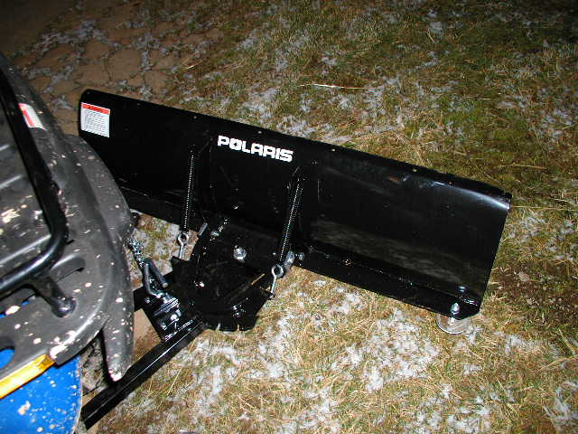

Here is a close up of the blade. It has 5 positions. Center and two positions off to each side. Plus it has shoes and springs to allow the blade to kick foward in case something hard is hit.

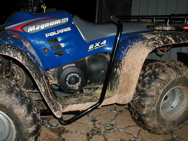

Here is a pic of the manual lift handle. I guess santa could not afford the electric lift kit. Maybe next year! But it is really easy to lift and lower. But you can only have it down all the way or up all the way. I just might have to do the elctric lift so you can have it at any position.

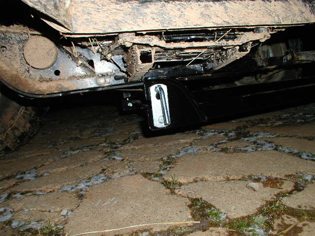

Taking the plow on and of is really easy. You just drive over it and at the end of the push tubes is a "C" bracket and then some little levers that snap over it and locks it into place. Off in about 1/2 minute and back on in about the same time.

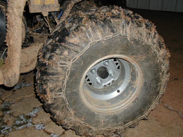

Did I tell you that putting tire chains on can be a PITA. I think I should get re-baptized for the things that I muttered trying to get them on. But wow can I dig in the mud.......thus the bath that is needed. /forums/images/graemlins/grin.gif
