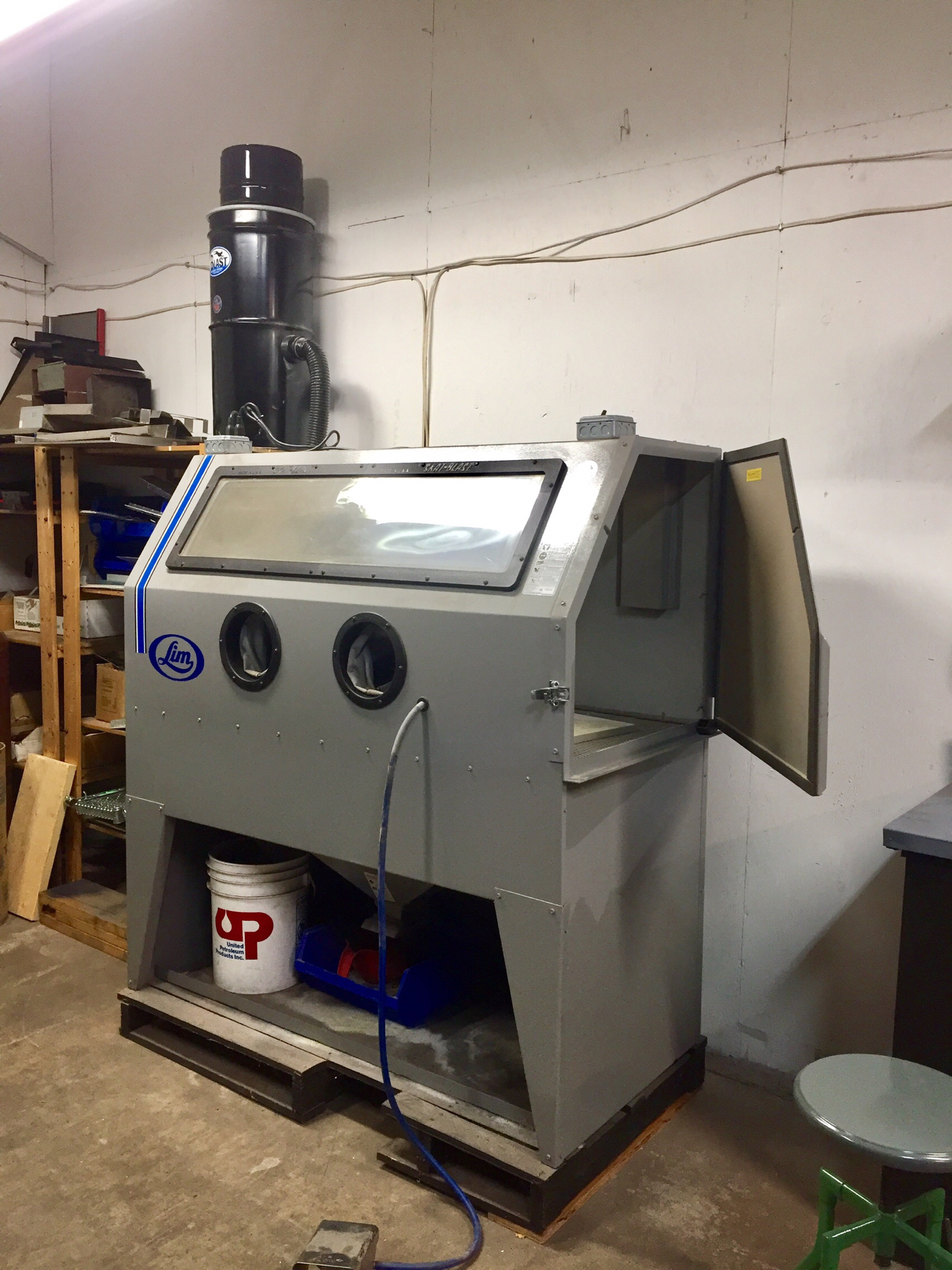

I have been looking at various units and was wondering if anyone has any input. Mostly to restore equipment. I have looked at the HF 100 or so lb unit and thought about buying their tank and a better nozzle. Also I would need to get a lot bigger compressor.

I've had the HF sandblast cabinet for about 5 years now. I think it sells for $179. and holds about 40 lb. of abrasive. I run it off my HD 80 gallon shop air compressor and it works fine.
I have used the HF 110 lb. portable blaster for larger jobs that won't fit in the cabinet (borrowed from a friend) but try to avoid using it. Its quite a pain spreading out a large tarp to catch the abrasive then shoveling it up once you are done. It also does a decent job.
I've only had to replace the ceramic tips a few times and replaced the glass viewing window once.

I have both a Harbor fright portable tank unit and a Skat blast cabinet. I use the cabinet about 100 to 1.
They are expensive but work GREAT- good lighting, filters, lots of media, and a lot of room to work.

X2 on Scat Blast cabinet. I also have a HF 40 lb. portable tank that collects dust in the back of the garage. To much hassle to setup & use. For big stuff I use electrolysis now.

X3 on the Skat Blast cabinets. I like mine too although admittedly I've never tried any others.
