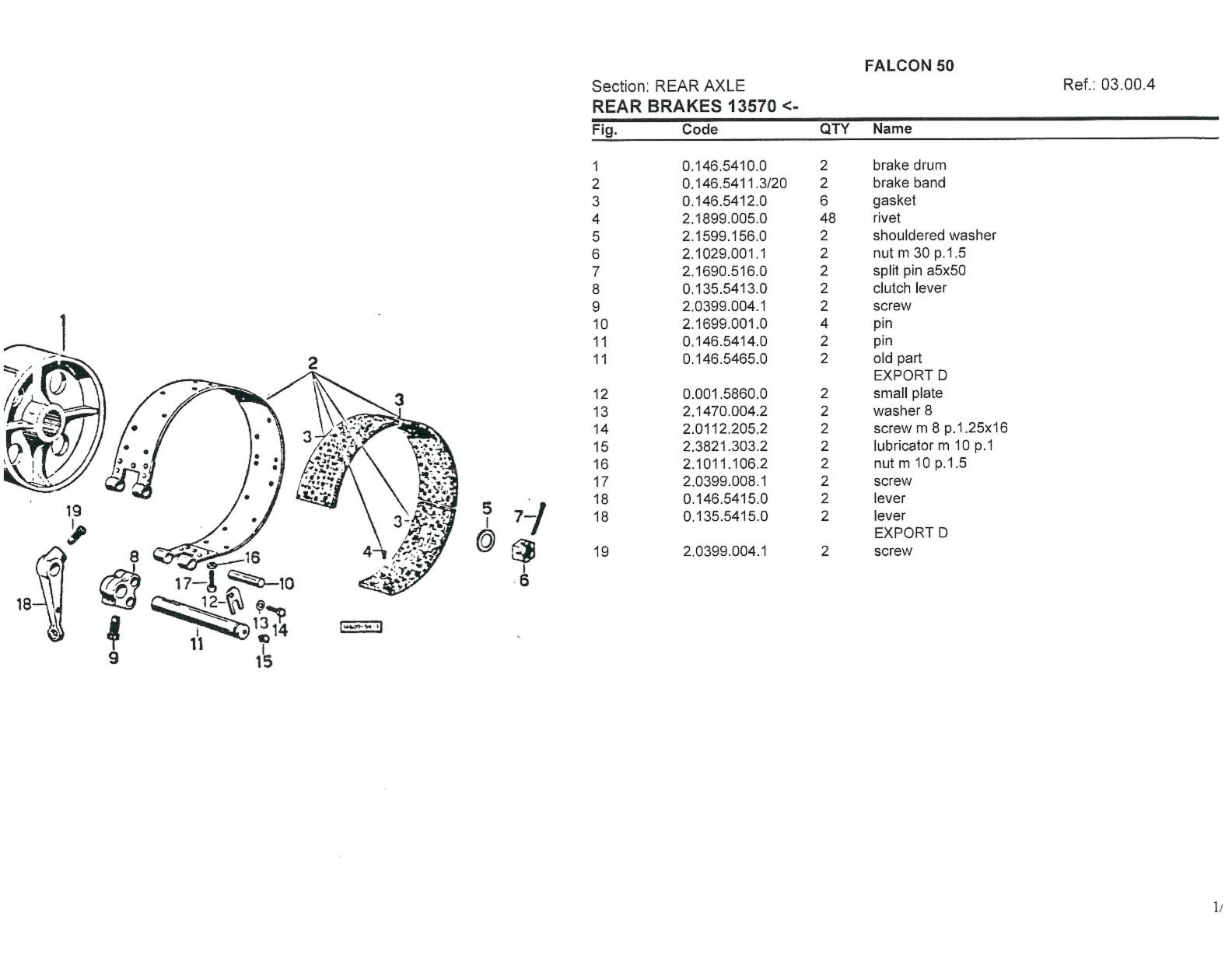

I am interested in buying a decently priced Same falcon with bad brakes.
does anyone have experience with these and replacing the brakes.
costs, parts etc.
any help would be great thanks joel
   / SAME Falcon 4wd #2
Brakes are available. I attached the breakdown. It is for a Falcon 50 the other model Falcon was a tracked machine.
Buck
   / SAME Falcon 4wd
buck,
I tried out the falcon. Liked it but needs brakes that's for sure. Could you see what the cost is on the pads and straps for the rear, a key switch and a manifold?
If you need me to call the shop email me the number and I will do that.
Thanks Joel
