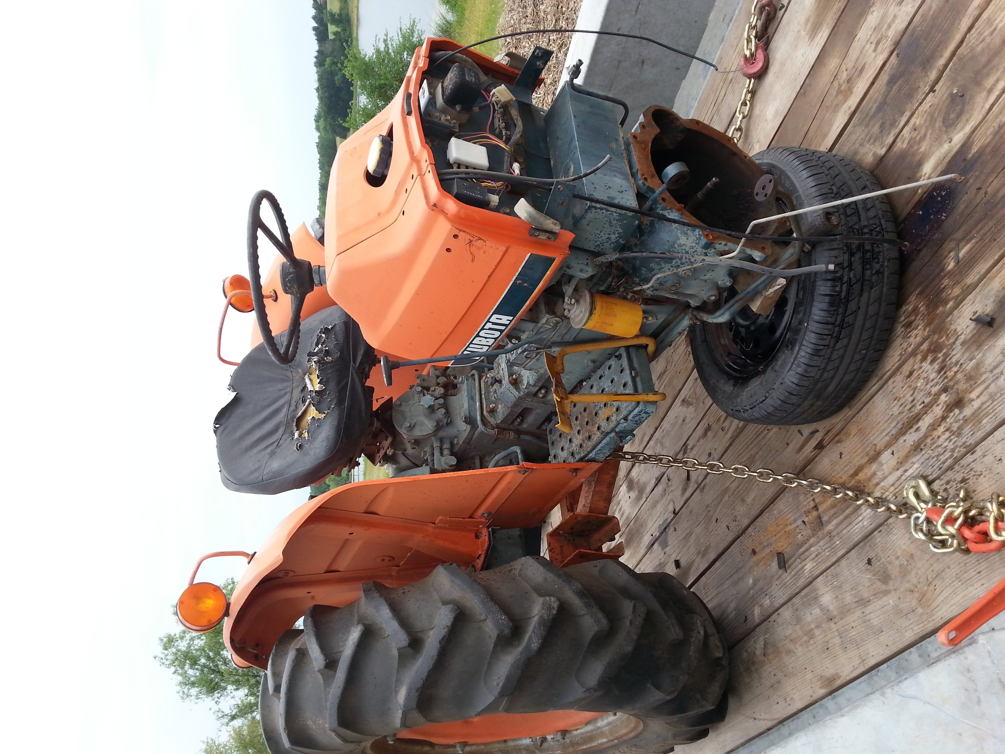

Do the the bores have ridges partway down from the pistons being stuck? Do you have a recommended diesel engine repair shop lined up? They'll help you decide what work the block & head needs. Sometimes, when a tractor has an unknown history but is already apart, a shop might suggest a full rebuild (rebore with new pistons etc). But other times it can make more sense to get it running again with minimal new parts (maybe just hone and rings) so you can see if the rest of the machine is worth diving deep on the engine.
/ Salvaging a L345dt / 1720 loader
#24
The bores look o.k. and are standard bore , the pistons had heavy corrosion on the aluminum body of the pistons and that appears to be what had the engine seized , the rings are stuck in the pistons but over all it does not look like the rings rusted to the cylinder walls . I do not have a machine shop lined up , I am new to TX and I have no idea who to go to or stay away from . I don't feel safe using the old pistons again , with the way the previous owner beat the rods up I can picture a broken ring land coming loose when I least expect it .
I have built several super charged engines over the yrs. even a few alcohol burners , so I think I'm comfortable giving the diesel a try , But at the same time I'm a little nervous since this is the first diesel I will be getting this deep into .
Also with the horror story's I have been reading about gasket sets with seals that do not fit and possible head gaskets being too thick and then having low compression problems , I just can not decide who to buy a rebuild kit from . I just can not get over the prices that Kubota dealers want for the gasket set . Do you have any recommendations , Thanks .
