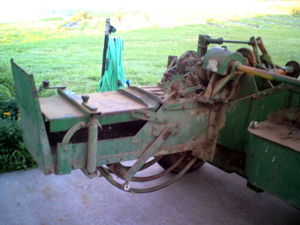

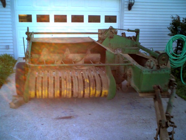

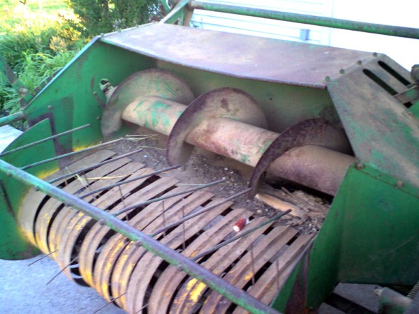

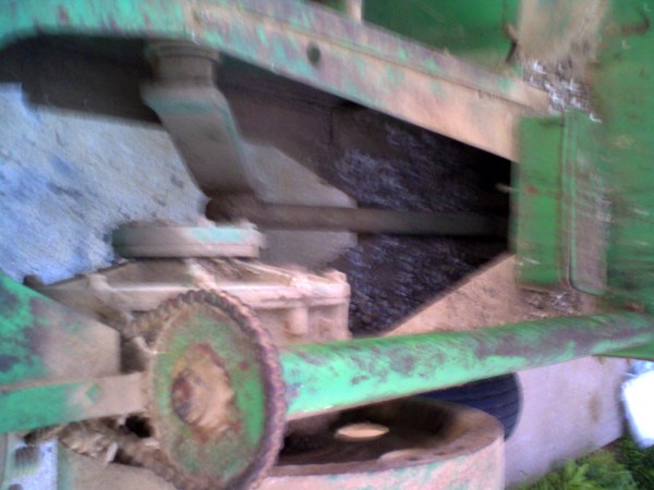

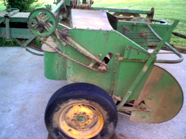

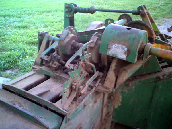

Here are some of the first photos of the baler after arrival (actually this morning)..

I'd put some priority on getting some of the covers and guards for the pto shaft and the slip clutch drum (near the main gearbox). These are high speed rotating parts and very likely to snag something (clothes, twine, hay, hands, pets, gloves, fence wire, etc.
Start by oiling up the chains with chain lube (not WD40). Check the gearbox oil levels, and mark each grease fitting with a yellow paint stick. The knotter frame area has quite a few on it.

BTW: IMHO that's a 14T, not a 24T model. That's important for part and manual coordination.
   / Saga - Gettign our first hay baler - JD 24T
#9
Now that's interesting to hear.. There's no paint stencil left readable above the twine box.. Where else might I find a label?
If not, what distinguishes the 14T from the 24T?
