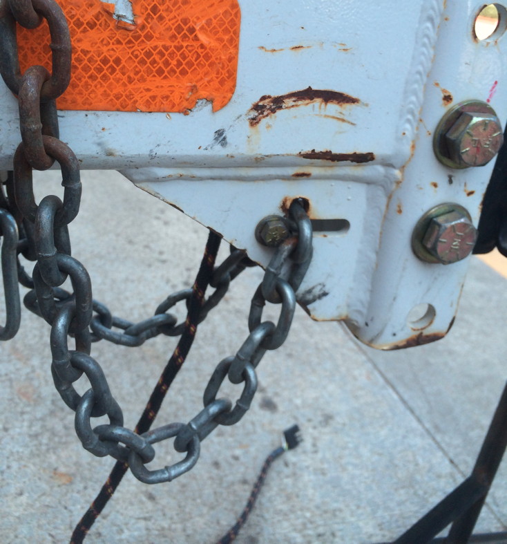

Picked up a used livestock trailer. When I asked the seller about hooking on the safety chain he said it just loops in front of the ball. Initially it seemed like a good idea but the more I've thought about it I don't like the idea of it. Big enough bump that causes the ball to unhook could pop the chain off, also if the ball were to break you'd be screwed. Any recommendations on what do with it? Do I use the looped chain at all? Or cut it off and just put some traditional chains on?
Here's a picture, the other side looks just like this side.

Personally I think you need new chains long enough to hook on to the proper points. The pins holding the receiver and ball might come loose for example. Balls do break, nuts come loose, etc. So the chains hooked elsewhere is a much better idea.

The safety chains on my trailer go - in an X pattern - to brackets attached directly to the pickup frame members. Safety chains have nothing to do with the hitch in any way.
   / Safety chain that loops on ball? #4
Just as Oosik said. You hope that it never happens but if the trailer does come off, the crossed chains should cradle the tongue and keep it dragging on the ground.
The breakaway for the trailer brakes is what often is looped over the ball.

Some states don't allow welded-on safety chains.
One setup I liked was a keyhole or banjo hole, with a bolt and large washer keeping the chain in the slot, but adjustable with tools.

The chains should fasten to a solid fixture other than the drawbar (hitch insert). Each leg of the chain should be rated at least what the trailers gross weight is.
