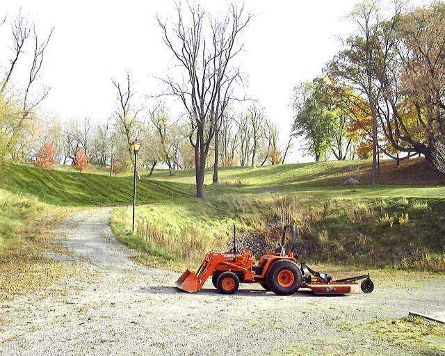

Newland, I have some pretty steep slopes to cut at my Antique shop property. (see attached photo) I just go up and down them and cut about once every 6 weeks. I take the loader off and find it much better, and more stable.
Von
Von, do you drive up and down the slopes shown in your picture? Or, do you back up and drive down?
