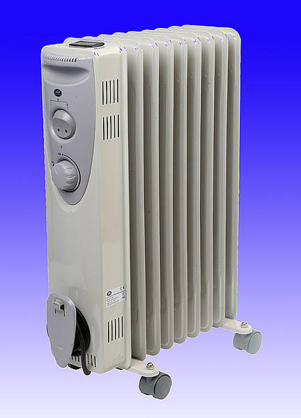

Thanks in advance for any advice!
We have a 4000 SqF post barn. It is clad in metal sheeting and walled on the inside with OSB. There is very old dry clumping cellulose insulation in all the walls and somewhat covering the 8' OSB ceiling. We framed and insulated with batts an area 16' x 16' for a tack room. The barn cats spend their nights there. We also have horses and chickens in separate areas.
I'd like to put in a safe heat source to just keep the chill off (50F-60F) in the tack room only. Today it is about 35F outside and it is 40F inside this (tack) room. It can get a lot colder in the winter but has never gone down below 25F in the worse weather. There is slight "venting" due to an ill-fitting storm door that goes out back.
We are in retirement so around a lot.
Any ideas for something safe?
   / Safely Heating a Tackroom #2

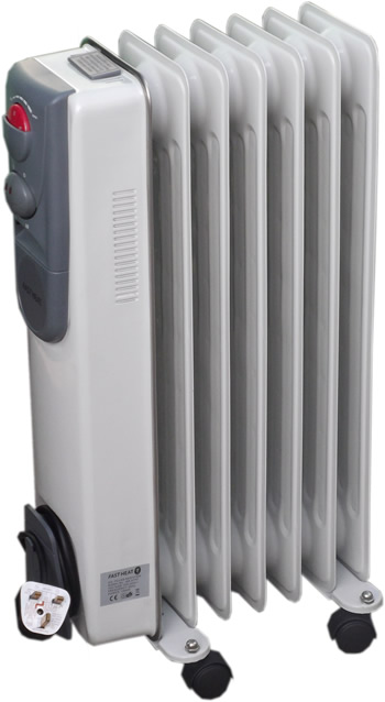

We have always used an electric oil filled radiator.
Get the old fashioned round dial thermostat. The new digital readout display type will not come back on after a power drop out.
   / Safely Heating a Tackroom #3
X2. I have heated my little work shed with one for 6 years. Works great and you never worry about fires because there is no element exposed. Also make sure you get the old dial or knob type. I learned about those darn digital ones the hard way.

Thanks for all the great advice. We purchased a DeLoungi Oil filled radiant heater at Lowes. Taking your advice I got the one with the "old school" knob rather than the digital model. It was half the cost but the same specs? 1500/900W, 5120BTUs, all the safety features we wanted. The ambiant temp at 7pm was 10C in the tack room. After an hour with the heater set on max setting 5 out of 6, the temperature rose to 13C. That was in a semi-insulated room in the barn. We are pretty pleased. We will insulate a lot more. Our model $79.99CND
