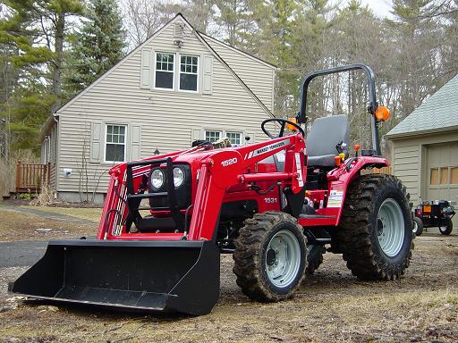

I just got my MF1531 delivered today, FEL, 6' rake, loaded tires, toothbar, & forks. Never had a tractor before but do have an ATV so am familiar with side hilling issues. On this tractor, does anyone know what type of angular grade is the limit before you get in trouble and may roll? Being new to it anything I go over feels wierd, but would like to know what type of terrain in a no-no.

15º is alright if you don't hit a rock, hole, stump or anything else Most people try to stay under 15º. You can go as high as 20º if you know the area and don't have anything on that will raise the center of gravity.
