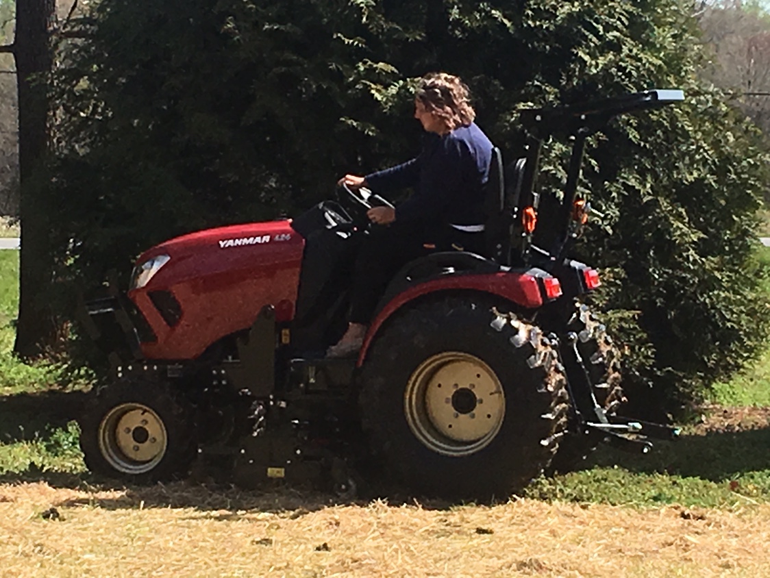

I replaced my cub 2544hd with a 424 I’d I love it I remove the fel and mow in low it’s as fast or faster that any skid steer mower and turns on a dime I filled tires with fluid and it rides much better I do not have ag tires IMG_4249.jpg

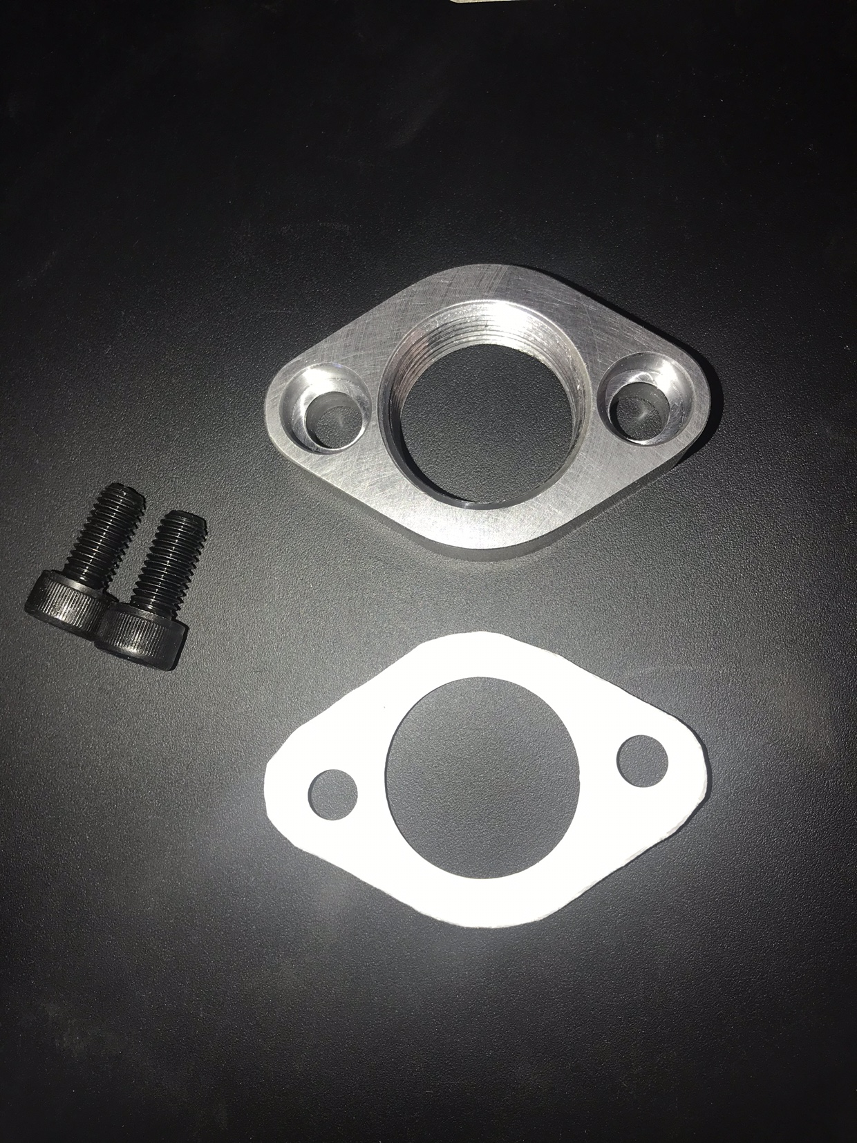

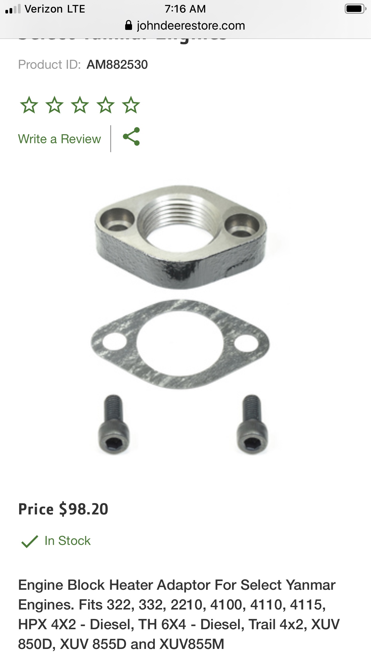

Ordered a OEM block heater kit for the engine to make some copies and resell so if any of you 324/424 and (221 ? Owners) need a new uninstalled OEM block heater kit let me know and let’s work something out.
Made some adapter blocks that mount to your engine, so if any of you need this part let me know and I will send along a new PTFE gasket and the proper hardware so you can mount. This will also fit John Deere equipment as well. IMG_5173.JPG
