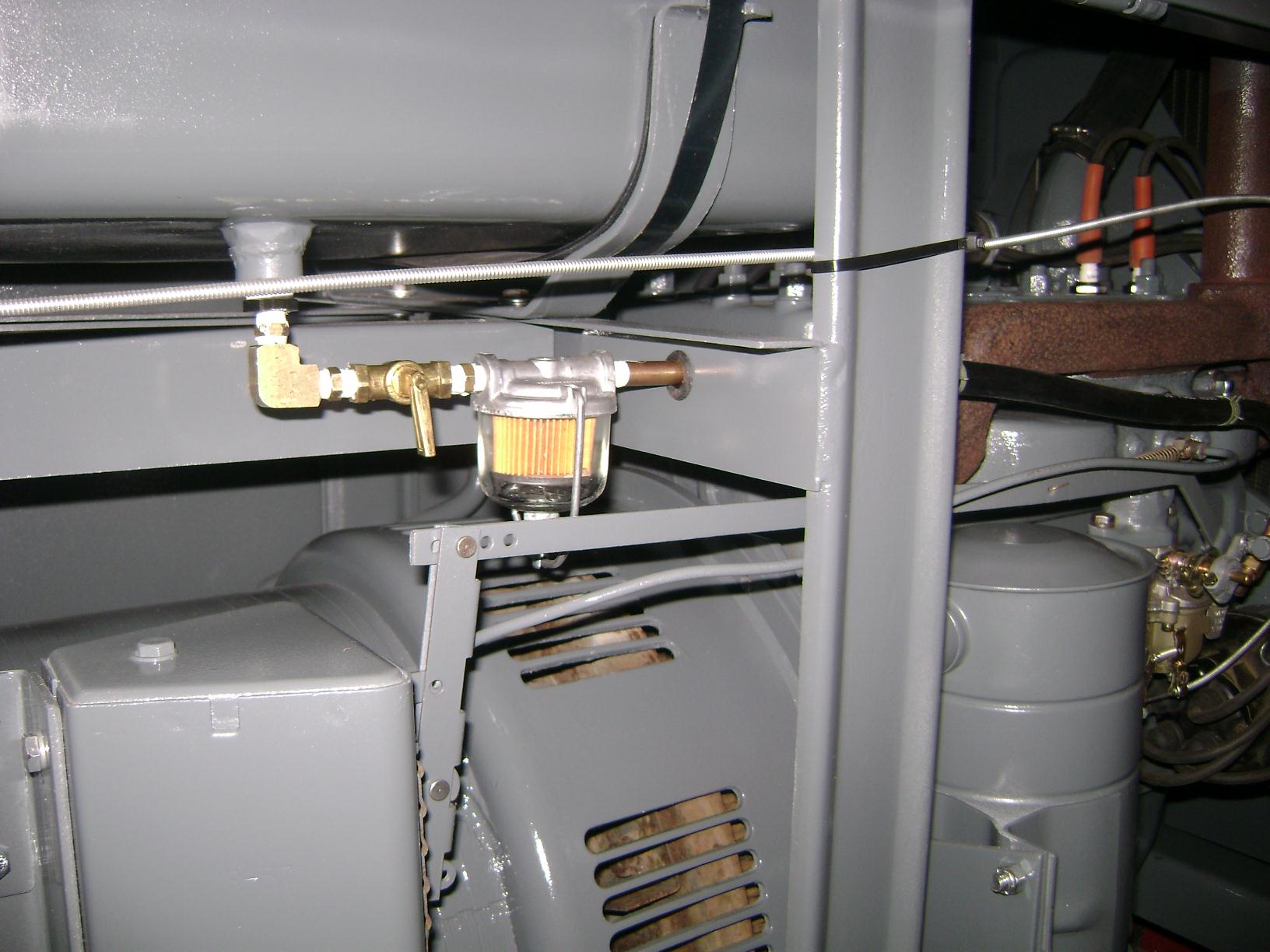

I only run ethanol free gas in my SA-200s. Also in my chainsaws, all small engines. I have a 60-gallon farm tank, I load it up on the truck. The next town south sells ethanol free gas. I also installed shut off valves in the gas lines of my SA-200s. I shut the valve off, let the engine run out of gas, then shut the mag off. I make it a point to run my SA-200s at least once a month. I'll run some 5/32-inch 7018 to get them warmed up real good:D.

We don't have much ethanol in the gas here, I think 10% max. Gas looked good in the sediment bowl. I have a shut off on the sediment bowl but it leaked when I shut the fuel off when I first installed it. I got it used off a combine. It may have just been dry from never being shut off but I'll check it again. It shut the gas off yesterday and didn't seem to leak but I'll see what it does after being shut off for a while. I did put some Seafoam type stuff in the gas which seems to help clean up the carb. Welder ran really good which is the most important thing.
