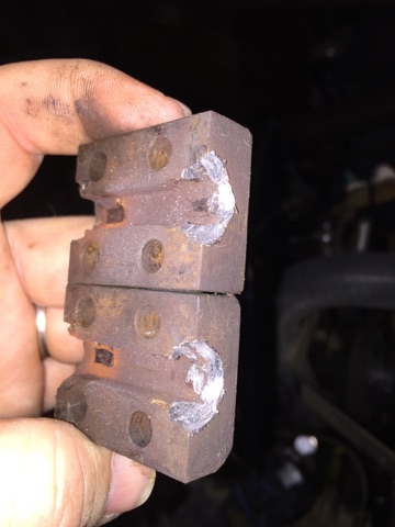

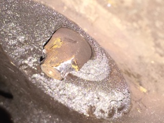

So... i pulled the transfer adapter off the pulley/pump this evening and I think this may very well be the problem. IMG_3764.jpg IMG_3761.jpg

I have exact same block issue.Seems like the block fits pulley shaft well but has play on pump shaft which ends up tearing up the block.Bad design.The only solution I have seen other then machine shop is to try the L050 coupler which is about 1.5 inches in length and will fit between shafts.The torque seems a little under rated though.Have not heard back on any forums on how long the L050 may hold up.
