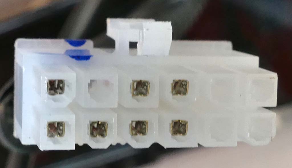

Anyway, mine is the cab version which has a factory-fitted radio, connected via a 12 way, 2 row Molex connector:
Interestingly, Molex call that the "receptacle", and the corresponding part which it fits into is called the "plug housing". (Seems A about T to me):p

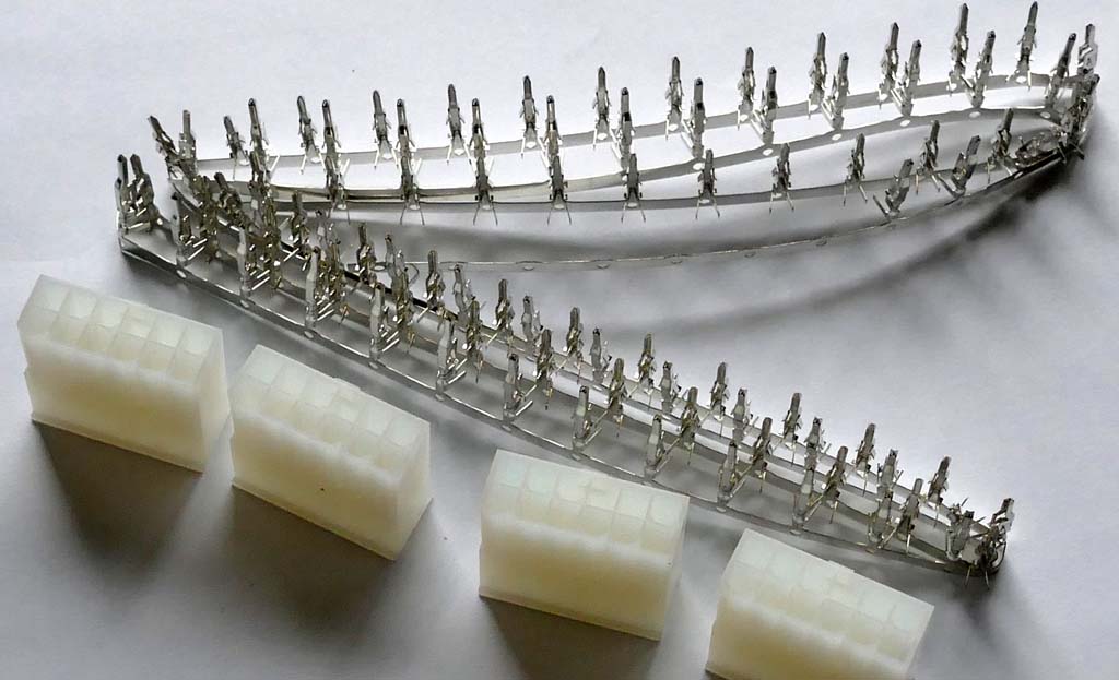

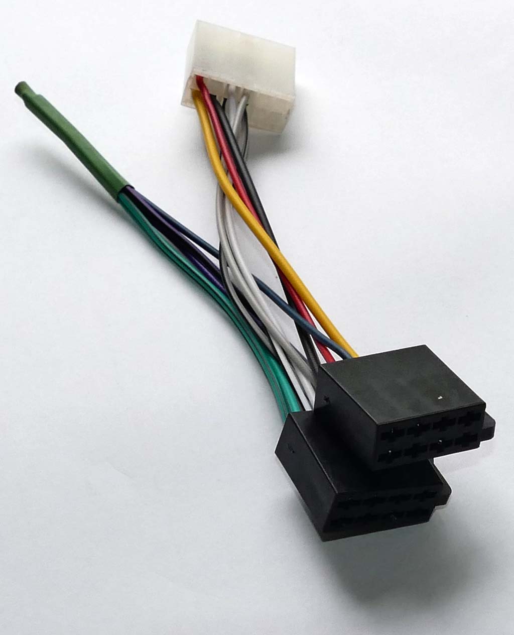

I wanted to replace the factory fitted radio with an aftermarket one which had a remote control, among other features. The problem was sourcing a matching "plug housing". It seems common Kioti plugs/receptacles are different from this setup, having typically 16 pins and a quite different format, so maybe it's the new format which Kioti is introducing on it's newer models.
I finally tracked down the bits I needed to make an adapter to go from the new radio to the existing "receptacle":
I had to buy more than I needed to comply with my supplier's minimum order quantity:
If this helps anyone in a similar situation, the part numbers are:
Plug Housing - Molex 39-01-3123
Contact (pin) - Molex 39-00-0040
When soldering the pins to the leads, be careful not to use excess solder which can cause the pins to not "home and lock" all the way in.
