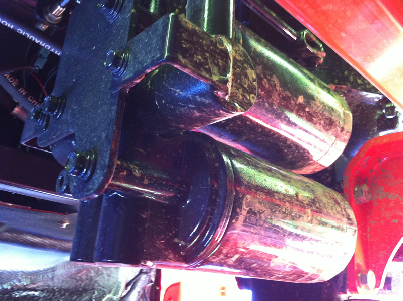

I bought a transmission oil filter, parked my RX7320PC on a hill (going up) and thought I was ready to do the 50 hour transmission oil filter change BUT I see what looks like two filters side by side. Photo attached.
Are there really two filters? If not what is the other one?
There is not much room under the tractor to get in there and remove the filter(s). Any tips?

Yes there are to filters. And it is going to be a bear getting those first ones off. Everyone says they are astounded at how tight they are. I broke two metal strap filter wrenches. What finally worked was the vice-grip chain wrench. You want to be as close to the base as possible. It still mangled the filter and ruptured and I got oil all over me. Once the filter was off I quickly wiped the magnet with a dry rag to try to remove any metal shavings. Then spun the new filter on. I had to use my foot to push the wrench. It was quite a chore.
