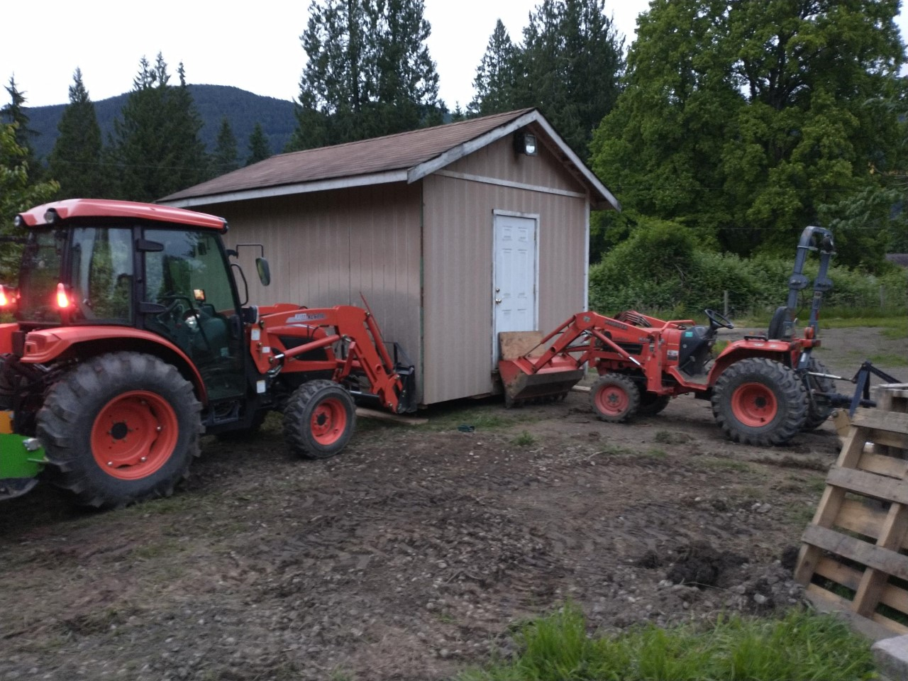

Oh, sometimes small is good (big tractor was doing the heavy lifting -picking up to reposition rollers- while the small tractor was doing the moving):
