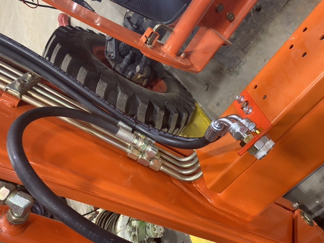

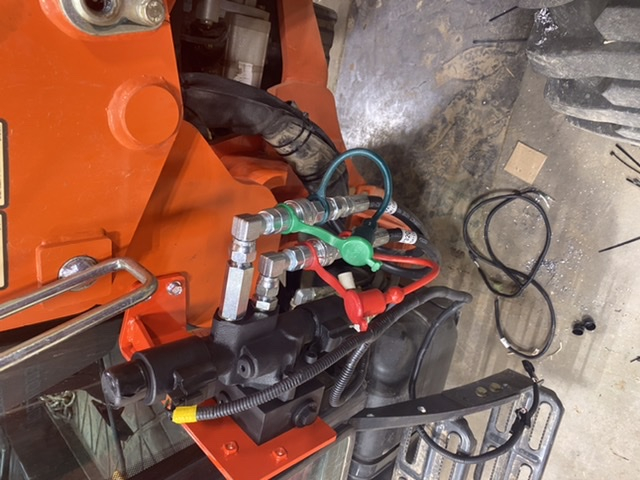

I ordered a third function kit from the dealer. Took about four weeks for it to come in. I am about halfway through the install. The kit itself appears to be very high quality but the instructions are horrendous. Probably the worst instructions I have ever received with anything in my life. Thankfully I have a decent understanding of hydraulics or I would have never figured it out. Installation requires drilling a couple holes through the 1” thick loader frame. Thankfully I had a magnetic drill for this. Drilling holes horizontally through 1” steel with a hand drill would be real fun.
I was kind of bummed it came with AG style couplers on the front. I asked the dealer if it came with skid steer style couplers and he said it did but it doesn’t. I will swap them out. Ag style are fine for the rear and are the standard but by far for SSQA attachments they are going to have skid steer style couplers.

I ordered my tractor with the kit. I think it's a dealership installed option. I have not received my grapple yet so I have not been able to try it out. On my DK4710SE the valve is down low and I am concerned that the hoses are vulnerable. I like how much higher you have mounted the valve on your tractor.
