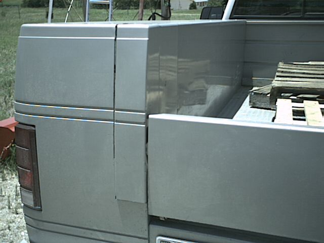

Robert, I really know what you mean. Several years ago (late '80's) I gave a '69 Falcon 6 and 500 bucks for a large OLD cab over camper. I just loved it. Then in '97 we got the biggest camper then made by Lance and I didn't want to burden my '84 Ford non-turbo diesel HD 3/4 ton with it. In 97 Ford did not build an extended cab dually 1 ton diesel so I am now a Dodge man (mostly).
Typical full sized pu bed is about 48 1/4 - 1/2 between wheel wells with about 56 between bed walls. My new camper has a lump on its side that depends on the wider dimension behind the wheel well. New truck has service body with no internal wheel wells but is only 52 1/2 in wide. NO fit! Soooo a tad bit of custom was called for. Maybe you can do something similar. I used a HD steel armature in the cut out piece. Damn heavy. Would do it over with aluminum, might still when get time.
Here are some dig pix of it.. First is with custom piece "IN" and tailgate shut. Next is with tailgate down. Next with custom piece out and tailgate down. And last, I couldn't help it, the devil made me do it, the truck. '97 1 ton Dodge dually with 19 1/2 inch Alcoas, custom bumper with winch, service body etc.
