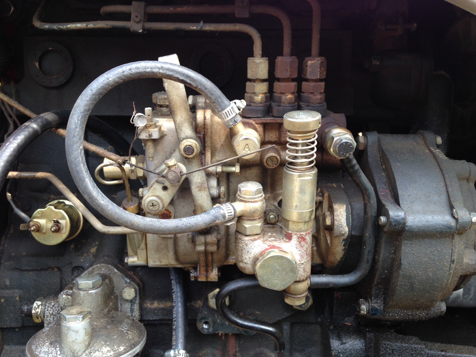

Hello,
My tank has gotten pretty rusty over time and I'm ready to retro a plastic tank. I would use a pour in liner but there are two issues; Deisel tanks are real tricky to get clean. Red Kote recommends sand blasting. How can you do that?? Send issue is that the first tank was "partially" coated with Red Kote and you can't re-coat with out total removal of the first coat. Red Kote tech help recommended filling tank with solvent. Both expensive and having 12 gal of nasty stuff at the end.
So I'm thinking of just modifying the tractor to use a poly tank. I have one standard on my Kubota and of course it has been clean from day one. Anyone know of a source of poly tanks? The link below is one site but only 2 sizes. I could fit the 6 gal version. Just wanting a bigger selection

Diesel fuel tanks will not rust on the inside if you keep clean fuel in them, moisture free and bug free, and keep them full when not in use. Just sayin'.

Usually there is a primary and secondary fuel filter on diesel engines. In the case of these tractors the primary filter is just the screen in the top of the sediment bowl. Some even have the notorious in-tank screen. Regardless of which way you go with the tank, I recommend that you treat your fuel with a biocide since it sits for some time. Diesel bugs are very corrosive, and can bring a diesel engine to it's knees.

New sediment bowl assemblies are almost a dime a dozen. Don't know if yours has the shut off or not, but they are plentiful. That little screen is pretty important because it helps protect the lift pump. Btw, there is also a nylon screen located in the banjo bolt of the lift pump suction. You might want to check that too if you haven't already.

Are you saying all Chinese tractors have this nylon screen? My tractor is a KAMA 454. Where on this photo is this banjo? Thanks for your help.
