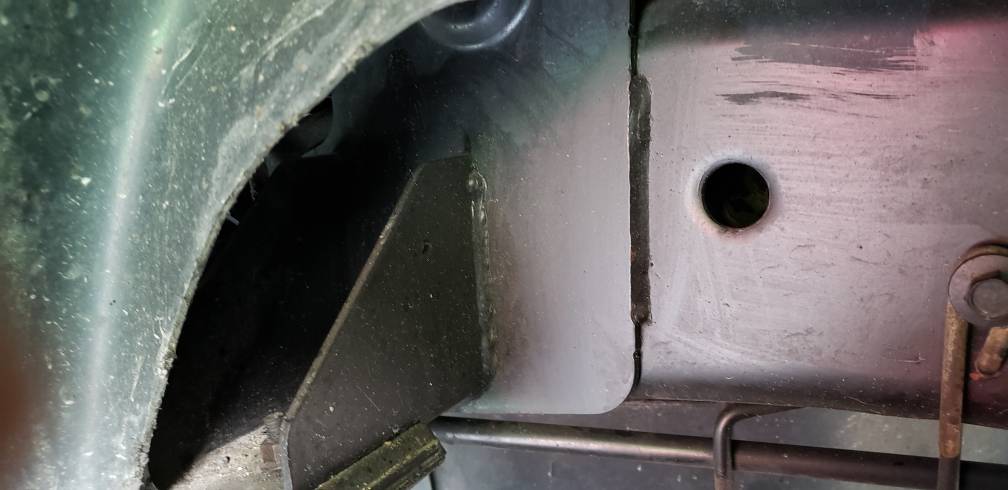

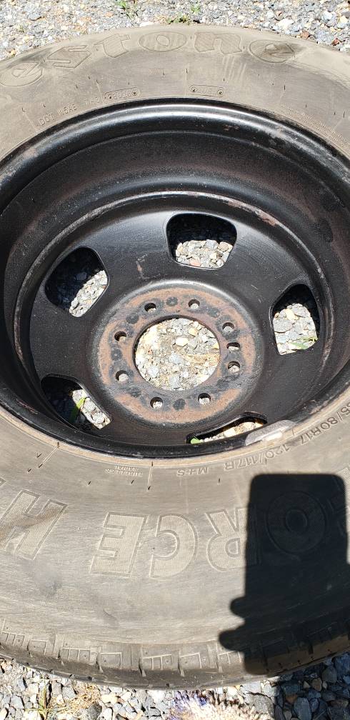

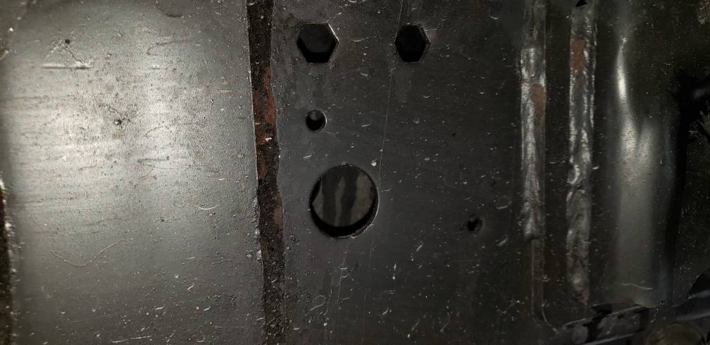

Rust up here in Mass is largely due to the mag chloride they use on the roads in the winter...it's brutal. I have a 2017 F450 V10 with 7,000 miles on it. The rotors rusted and now pulsate under braking,the exhaust at the converter is rotted, the dump body hoist looks like it's 15 years old and rusty. ..and yesterday I got a tick from the drivers side manifold high means the studs rotted and need to be replaced. It goes in next Wednesday to the dealer for that. ...it may not come home with me...
