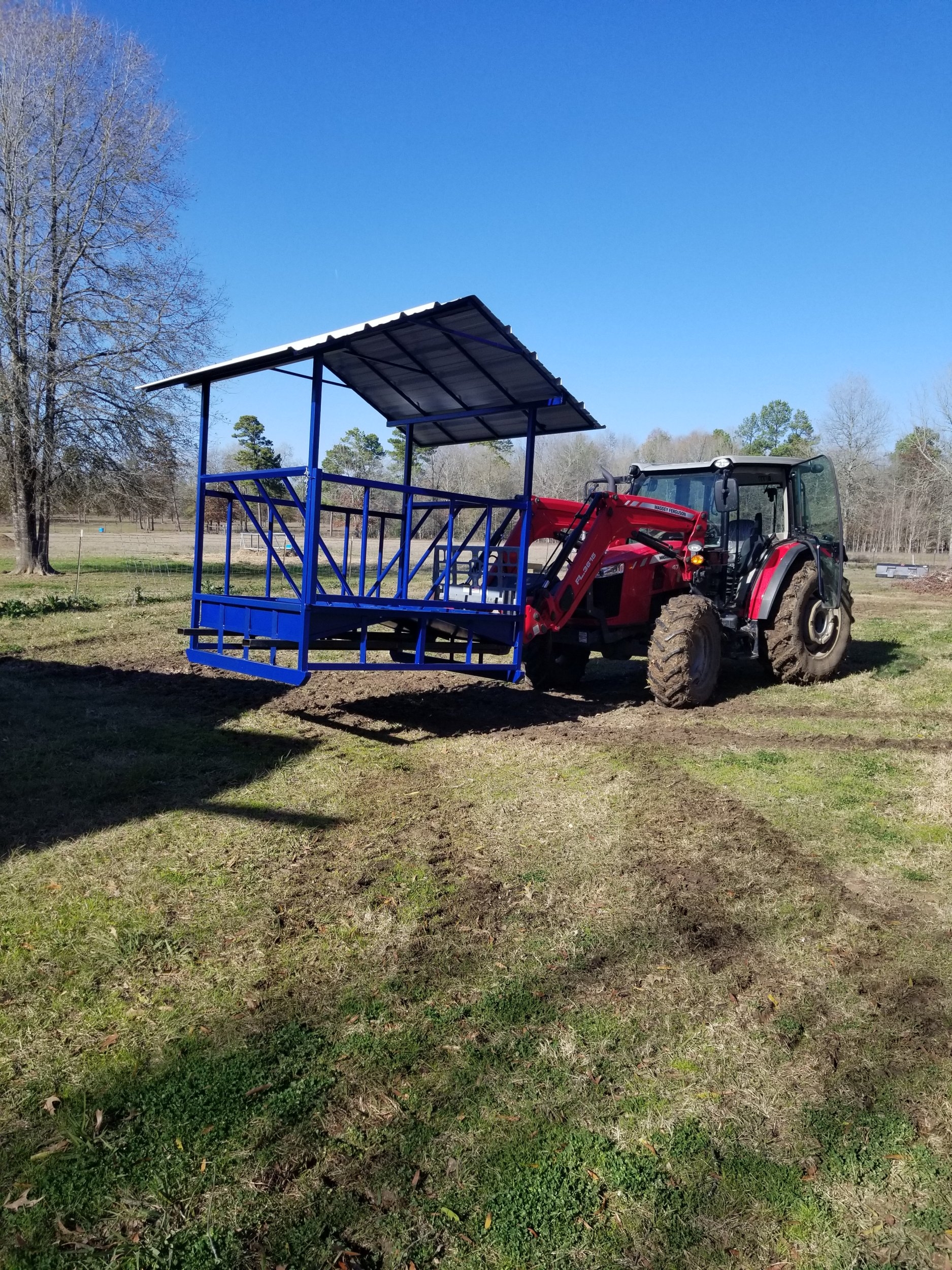

I've got a project similar to this I'm hoping to get done in the next couple of weeks. I built three covered round bale feeders that work wonderfully, but over time with the cows rubbing on them and all the environmental factors they get some bare spots that start to rust. Got them pressure washed and order some Corroseal rust converter from Home Depot. We'll see how it does. I've used similar products in the past with usually good results but not always. I looked at some of the other products but a number of them had ingredients toxic to animals. The toxicity of this one appears to be very low once it's cured.

Good job on that feeder!

Thanks! The feeders were a lot of work and I built two by myself so all the fitting and fabricating just takes longer. But the ones I found online were $4k and I built these for about $1,500 each. They save so much in hay loss I figure they'll pay for themselves in about 5 years.
