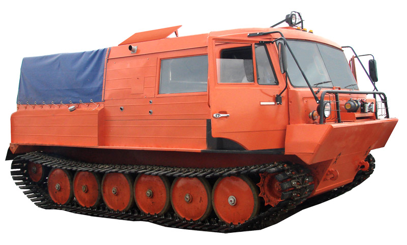

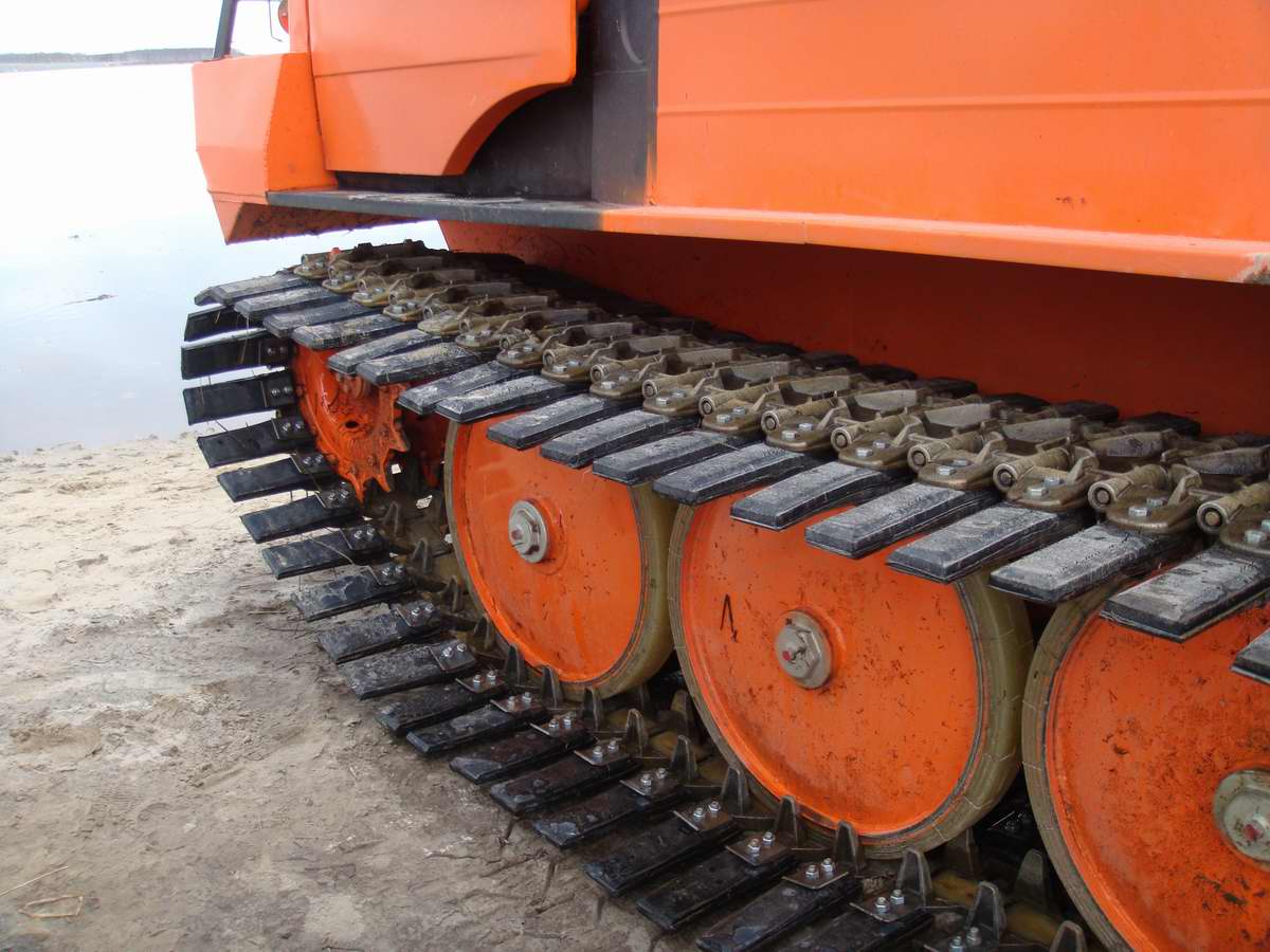

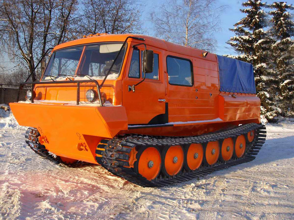

I hope to get a little more information here about this vehicle. I'm considering trying to purchase this "Transport" TTM-3 from Russia. Haven't seen in it person but have talked to two russians that have maintained and operated this machine. It's a one owner purchased new for $100,000, currently under 600 hrs, 4 man cab, new tracks, well maintained w/records, all manuals in english come with it as well as a few new spare parts. These are quite heavy and appear well made, they seem to be popular in northern regions of Europe and with oil service companies but I don't have any personal experience with one.
Looking for opinions/input from anyone that's been around or operated one (or something similar) concerning quality, durability, weak points etc? If the price is right and I don't find anything too concerning with this model TTM-3, I am probably going to buy it. Unfortunately, there just doesn't seem to be a lot of info online about TTM so any thoughts or information would be much appreciated.
Basic specs from their web-site:
Curb weight, kg 6530
Load-carrying capacity , kg
3000
Mean soil pressure, kg / cm 2 0.17
Maximum speed, km / h 54
Maximum speed afloat, km / h 5
Number of seats in the cabin 6
Number of beds 2
Fuel capacity, l 400
Size of the loading platform (L*B*H) mm 2350*2200*2050
Overall dimensions (L*B*H), mm 6480x2940x2600
Body width, mm 2500
Engine Cummins-4ISBe185
turbodiesel, P4, 4.5 l., 185 hp
Transmission 6-speed, manual, ZF 6S1000 (Germany)
Control steering wheel with hydraulic power booster
1066_TTM-Z-4901-_gusenici.JPG147_3gr.jpg152_1.jpg155_4.jpg156_5.jpg974_Povorot_843_6.jpg1046_Izmenenie_razmera_TTM-Gruz.jpg1052_Izmenenie_razmera_Organi_upravlenij_TTM.jpg1057_Izmenenie_razmera_CernSKAN_i_KAMAZ.jpg1059_Izmenenie_razmera_gr-plav.jpg

There is no way I would contemplate purchasing/running a Russian tracked transporter - IMO all too hard & too much risk, & with the manual transmssion (as you have described) it would be an absolute "orphan" in the market - and at anywhere near the max quoted speed of 54kph the tracks, chains, rollers, idlers & sprockets are going to have an extrememly limited life........add to that the amphibious capabilities & this "thing" is going to cost mega $'s/hour to operate/maintain.....
