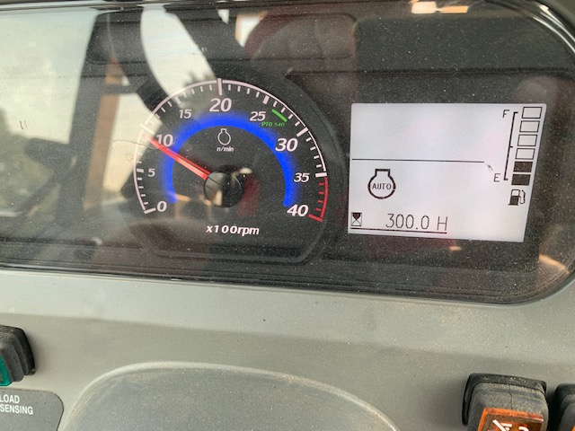

Please let me know if anything should be corrected.

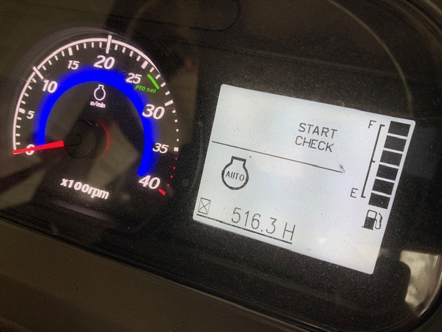

The 550-hour service at 516.3 hours took me about a day and a half to complete, a little earlier than recommended (except fuel filters) because it is the beginning of heavy-use season.

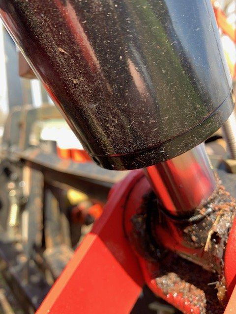

  • Earlier this week, I posted on another thread Anyone have 300+ hours on their RK55? about my experiences over the past almost-550 hours saying “Almost 550 hours on my RK55HC - preparing to do a second hydro change plus full service. Problems: leaking right tilt cylinder on loader (warranty), getting the filters off for the first change (see my 50-hour service thread), backhoe pin without a grease fitting (warranty), 3rd function gets "confused" at times, oozing 3rd remote, sticky 3ph control. Biggest complaint is limited visibility of loader implements (bucket/forks/grapple) due to the high hood compared to my 23yo New Holland TC45D, especially when changing. Other than that, this thing has been pretty good. Lots of mowing with a 7' finish mower and log moving/brush work with grapple.”
