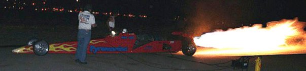

This is the only thing I've ever run straight kerosene in, lol.
