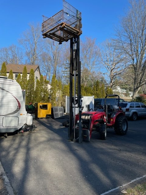

I have added a 3 stage forklift rack to my tractor for high lifting. It works super good, but I'm running this single acting forklift rack off of a double acting valve meaning that while i'm lowering the forks the valve is deadheaded which can build heat and is not ideal. I'm using a Prince Stack valve so I could easily just add a single acting valve to the stack to solve this. Adding the additional section is a easy and cheap solution, but I'm wondering if I can do better. I'm not lifting heavy weights, so the forks take forever to lower. I was wondering since I have a double acting valve anyway, could I use a Venturi vacuum effect to suck the fluid out of the cylinder to increase the lowering speed of this single acting cylinder? What do you think, any legs to this idea? The concept works with air which is a "fluid".

If it were mine, I would add the single acting valve and be done with it. You don’t want a lowering circuit to run too fast due to safety and risk of cavitation

That's an interesting concept, but I'm trying to understand how that could be put into practice with a double acting valve. You currently have a single acting ram which uses one port for input and output. Your double acting valve which presumably is an open SCV type has 2 cylinder ports. When you pull the lever one way you get pressure down one of those ports and the other port opens to reservoir. Pulling the valve the other way will give flow out the unused port in your SCV, but what I'm unclear on is how you could use this flow necked down to create a vacuum plumbed in to your single hose for your single acting cylinder WITHOUT providing a bypass to reservoir when you want to extend your cylinder. I suppose it's possible using solenoid valves or a complicated arrangement of pilot operated valves - or am I missing something here?
It would seem to me that adding the single acting valve to the stack, trying to identify and address any restrictions in the plumbing, swapping to a double acting cylinder, or reducing cylinder diameter would be simpler solutions

That's more or less how I run mine. Even though I'm using a double acting cylinder on my dump trailer, I'm using it as single acting with a breather on the non used port of the cylinder. In my case, since I have an hydraulic winch, I run the winch in free spool as I lower the dump trailer. Works great and I'm not forcing fluid through the relief valve at max pressure.
You can either add a single acting valve, probably the best move if you don't mind the cost too much. Or run a hose straight to the tank on the not used port on the current double acting valve, probably quite a bit less costly too.

Get a valve with the float feature.
Use the float feature to lower the mast.
This way you still have the use of the valve for other applications.

Just so you can see what this contraption looks like.

I would run larger hose since that would help increase flow at low pressure when gravity lowering. You probably only have around 200 PSI load induced pressure with empty forks.

The float type valve is a great idea for single/double acting on the same SCV. I still which I could pull this down faster. It probably takes 2 minutes to lower this.
Larger hoses might help some, but it was still quite slow even in it's stock configuration on the forklift I robbed this off of. I used that old Clark electric forklift for 10 years or more until it finally broke enough to scrap it. I suspect some of the problem is age. There are many gears, chains and rollers that probably don't roll as well as new. A tiny bit of friction here and there all adding up along with the undersized hoses & SCV valve.
