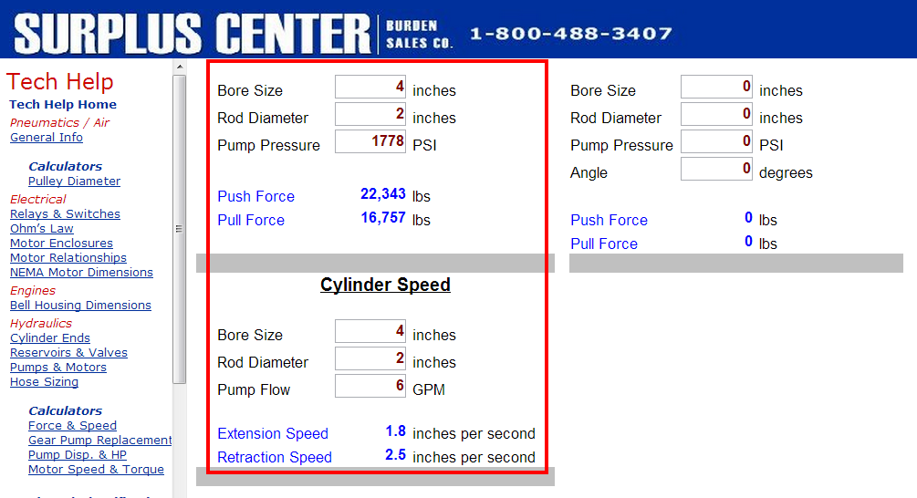

If using 6 GPM for the flow, here is the data for the cyl power and speed.

I guess one way to get around the problem is to just have a pto pump with hydro tank but that kinda defeats the purpose of what I'm trying to accomplish- especially when i have a 23hp diesel at my disposal and i cant even utilize it for a simple log splitter! Is there no other way other than a pto pump?!
Thanks for that data J J

You have about 1.8GPM going to the priority valve for steering, PTO clutch and Hydro charge.
So you will have around 4 GPM left for splitter. I have a Speeco 34 ton stand alone splitter with a 15 second cycle time or you may use a PTO pump for quicker cycle time.
When I am splitting large blocks I use the BX to move them.
