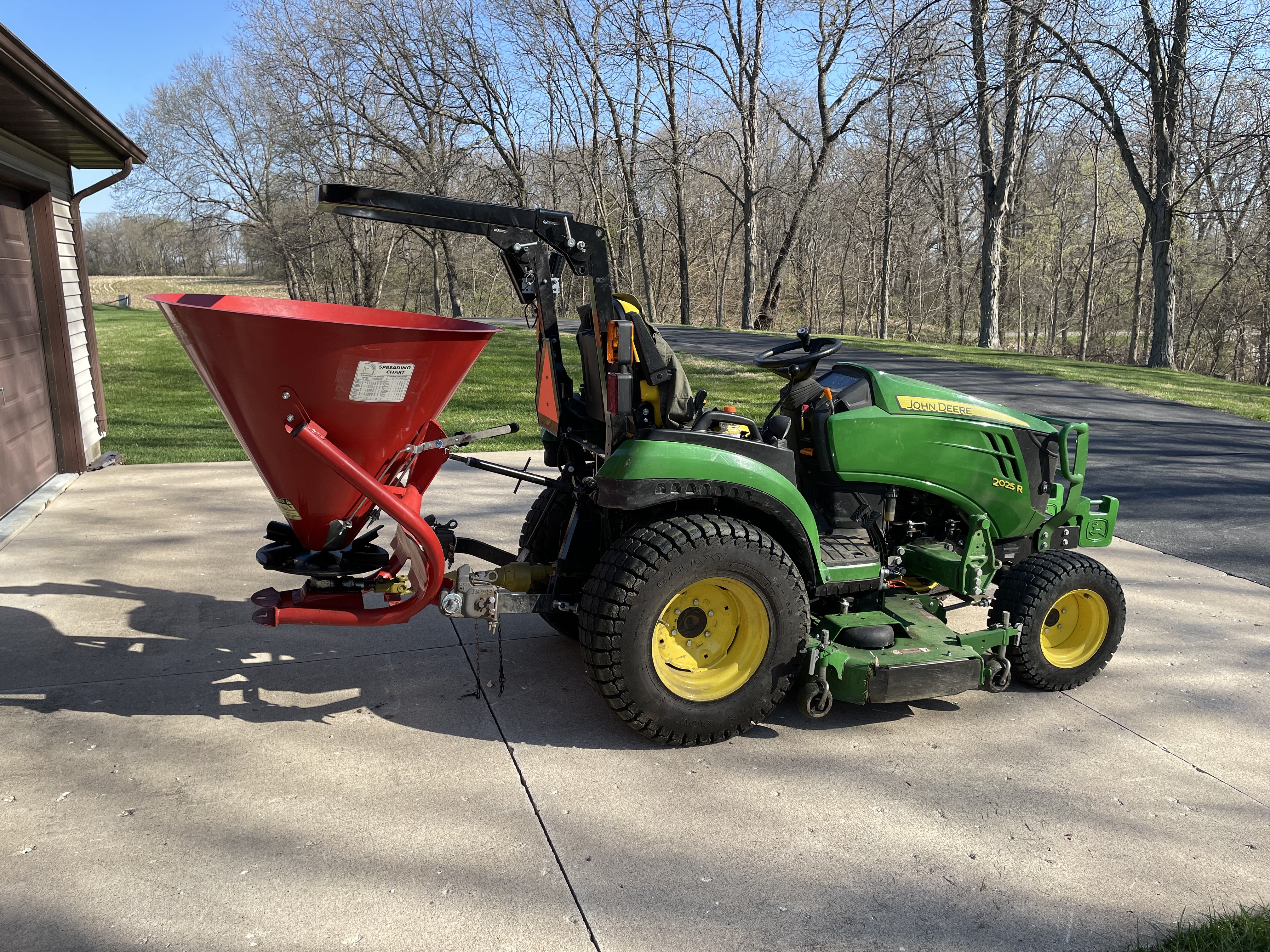

I have a pretty good sized spreader I ran on my BX a couple of years. The hopper was a little close to my head but it worked fine. A picture of the spreader but on my JD.

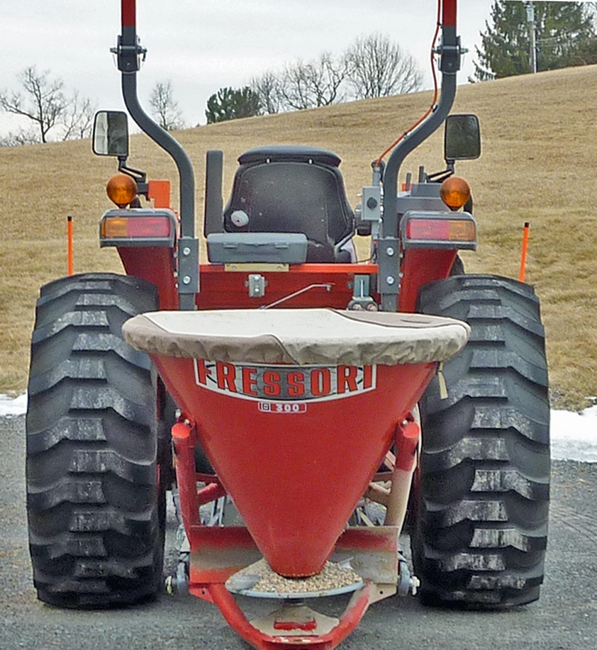

I used an old Fressori ag spreader on the 3pt of all 7 Kubota's I've owned, starting with a 17HP B7100HST.
Has worked well for almost 40 years to spread coal ash on the road.
The only thing I did was remove the PTO driveline and install a hydraulic motor on the spreader gearbox. That way, I can control the spread rate independently of the tractor ground speed.

   / Running a fertilizer spreader on a BX 3 point hitch who does it

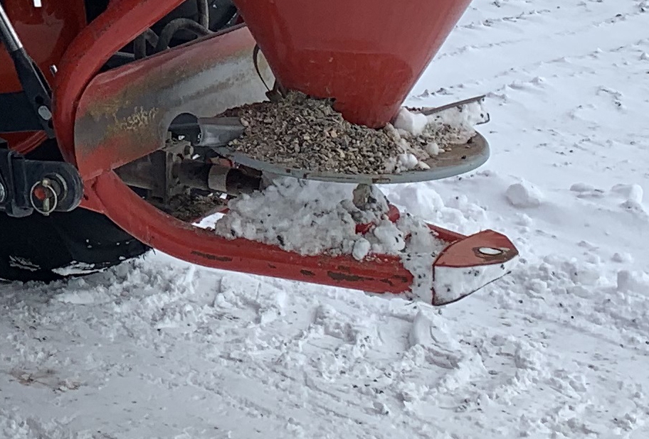

How did you mount the motor to replace the pto drive
You can't see it very well since the spreader is caked with ash & snow.
I bought a hydraulic motor rated at 100 rpm, much slower than the 540 rpm PTO. I found a 5/8" keyed shaft adapter for the motor that had a spline which matched the spreader gearbox. To keep the motor from turning, I welded a tab on the mounting bracket and cut a slot in the spreader frame for the tab to slide into. Set screws keep it from sliding off.
Works great using one of the rear remotes.
