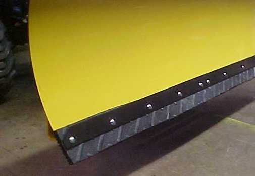

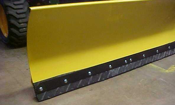

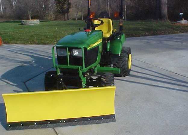

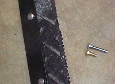

See these pictures, a $25 horse stall mat cut 4" wide by 54" and sandwitched between the cutting edge and blade, works like a champ.
