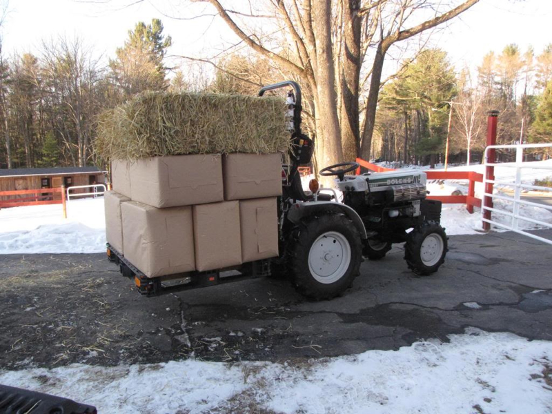

We have a lot of them in our barn and around our small farm. I have fought with these stupid things for about 15 years and they seem to get heavier when they get older. The best way that I have found by far to move them is by using a carry all attached to your 3 point hitch with a pallet on it. You just lower it next to them and slide them onto the pallet. The weight of the Mats holds them in place from sliding off of your lift all. The lift all is a very useful tool to have for many other projects as well. I use ours to do fence line by a putting my compressor on the back with my portable generator so I can use my pneumatic nail gun. I also haul hay and grain with it all the time. Hope this helps a bit and good look with those back killers..

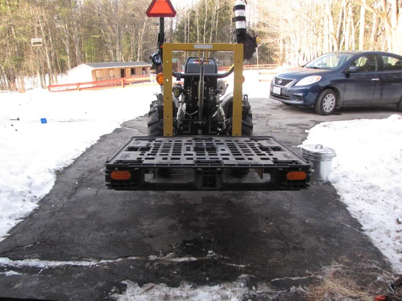

Hope that helped a bit! We move them around all the time, and I fought with them for years before using the carry all. They are not very expensive to buy one, just about $125ish. This is mine with the pallet attached. I just lower it and slide the on. The pallet only sits about 4 in high.
