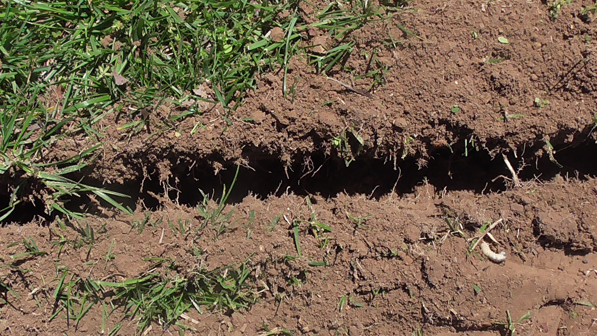

Nice tracks farmerboybill! I also have a BCS trencher. Have used it a few times. I like it. I have a short video of me testing it for the first time. I will upload to youtube and post the link for those interested (probably tomorrow). Its too bad they don't make it anymore. From what I understand they only made 100 of them. Mine does not have the guard and the wheel in the back. For now here is a pic I found of what the trench dug with the BCS trencher, looks like.

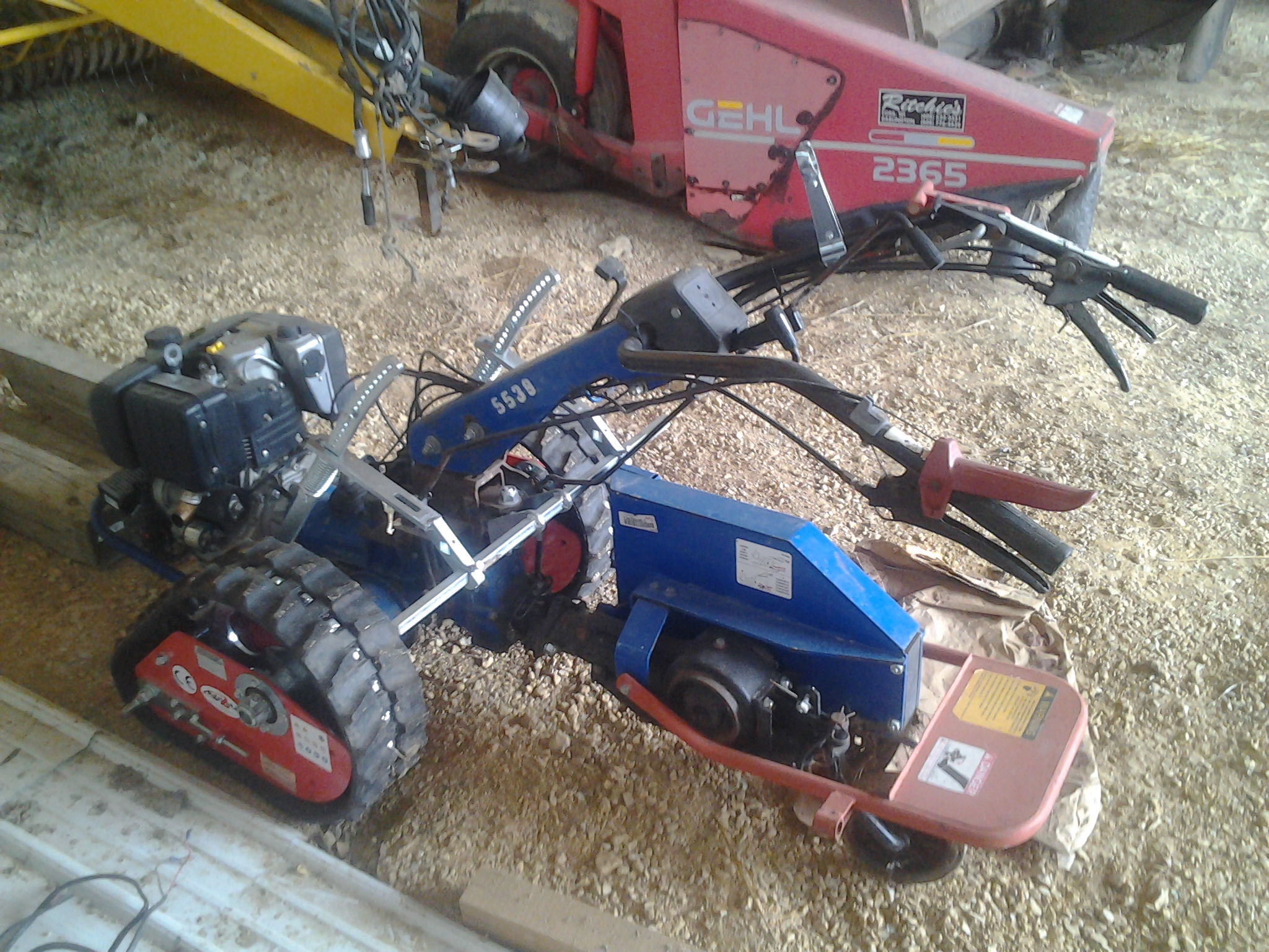

I guess you stand on red shelf at the back to hold it down...Pretty cool
   / Rubber Band Commerical Two Wheel Tractor #7
I don't know for sure, but I doubt the intent was to stand on it. Safety issue. Most likely its there as a safety guard. I uploaded a video of me testing mine back in the spring. I like the trencher a lot. check it out. It is a shame they are no longer made.
   / Rubber Band Commerical Two Wheel Tractor #8

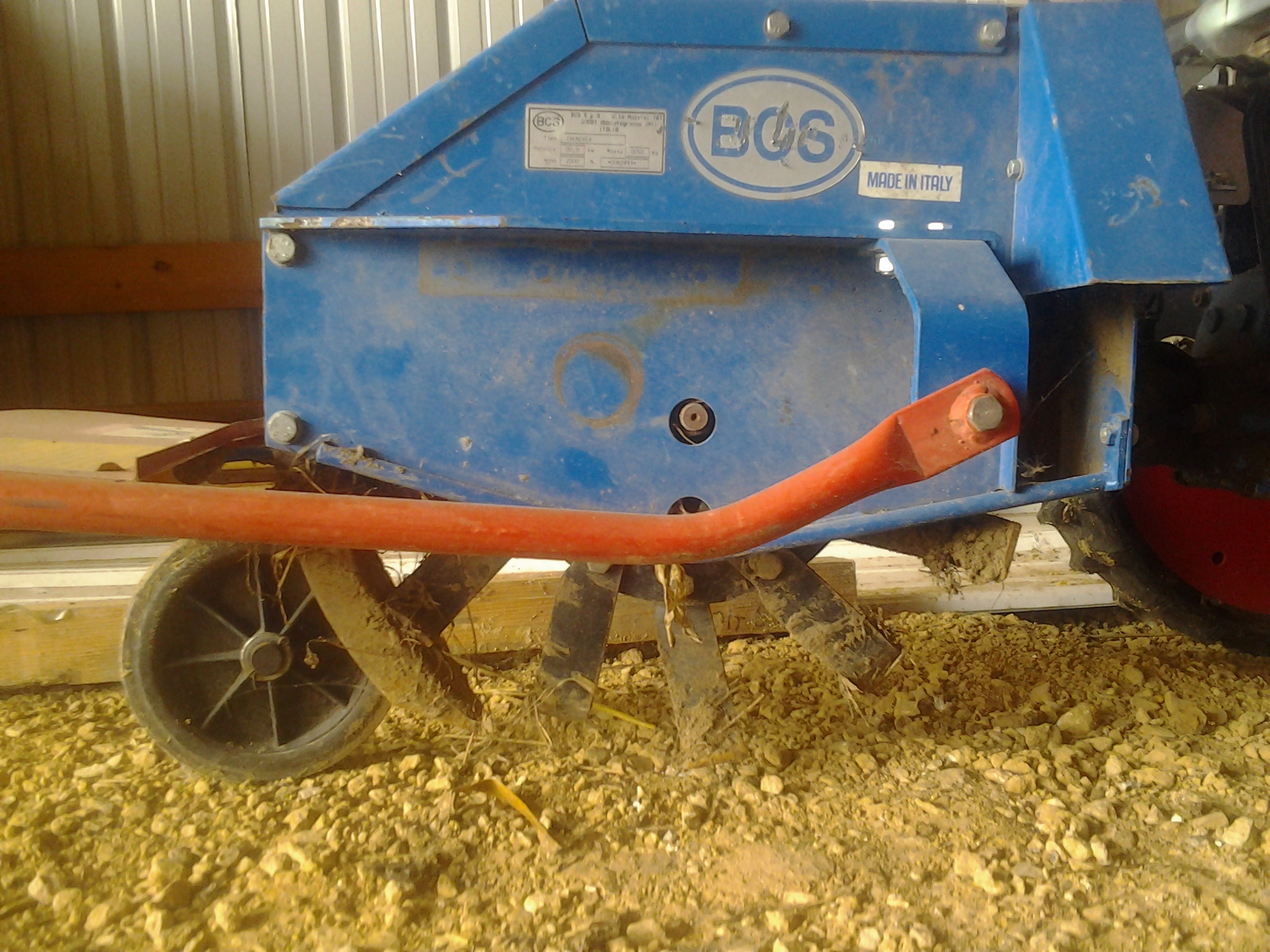

It goes in the ground with zero effort. It is essentially a 2 inch wide tiller with a discharge chute. The wheel goes where it is in the picture for transport only. It goes into the sideways pipe on the shield when in use. Keeps the shield from dragging on the ground. It's a very seldom used attachment. I used it once to mark out landscaping for a person, and used it again to plant raspberries where I didn't want to tear up too much sod.
