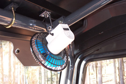

If you'd still like the wind in your face then look at the attachment.
This cost $14 at Consumer Auto Parts. I used five minute epoxy to attach the mounting bracket to the top frame of the windshield. I also reversed the mounting arm to aim it to help defrost the windshield. In the summer I can switch the arm again and aim it at my face. You can also have this oscillate side to side.
It comes with a power plug for the lighter socket. I'd like to find a switch similar to the one used for the heater blower so that I can vary the speed. Maybe something similar to a light dimmer switch. I looked at Radio Shack but couldn't find one. Anyone know a source for something like this?

   / RTV900 worksite #8
NAPA auto parts has a switch for a heater. It will allow you to control the fan speed.
   / RTV900 worksite #9
FL Cracker,
Thanks for the suggestion but I belive the Kubota heater switch is made for a motor with two separate windings so has three wires - hi/lo/ground. This wouldn't work with the two wire set up for the fan I'm using. I'll have to get a flashlight and check this out for sure. I'm just going by the set up instructions that came with the heater right now.
jpalasek,
Thanks - I'll check out NAPA tomorrow.
