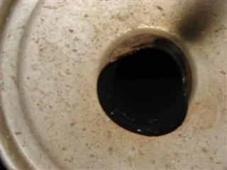

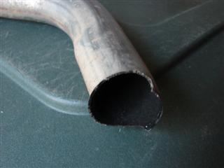

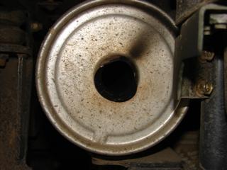

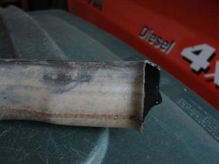

Well, the tailpipe on my RTV900 (320 hours) fell off. The muffler is still there. :)
I don't believe I hit it (or could hit it) on anything. Maybe the spark arrestor got plugged and it blew off??
My thought is to just run it as is. Should I worry about the nearby hydraulic reservoir?
This happen to anybody else? Is the fix to buy a new muffler/tailpipe assembly or would you weld it?
Thanks for the insight,
Neil.

i had the same thing happen on an 04 900. new muffler was close to 300.00 if i remember right. ended up taking it to local muffler shop. they welded a new tail pipe on an put rubber mounted brace on it for 40.00. was very satisfied with fix

Thanks BigDeer,
Do you know why yours came off?
I'll go talk to a muffler place.
Take care!
   / RTV900 Tailpipe #5
don't know how it fell off, i just noticed it missing one day. thought i might find it laying in the trail sometime but never have.
   / RTV900 Tailpipe #6
I would keep the spark arrestor off anyway,,,,, they don't do nothing but clog up and choke down power !!!
Muffler shop would be the best route to take !!!! :cool:
