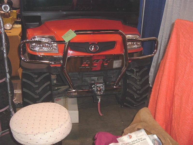

I have seen the RTV with the 26X12X12 from the rear of the BX series tractor, sure looks tuff.

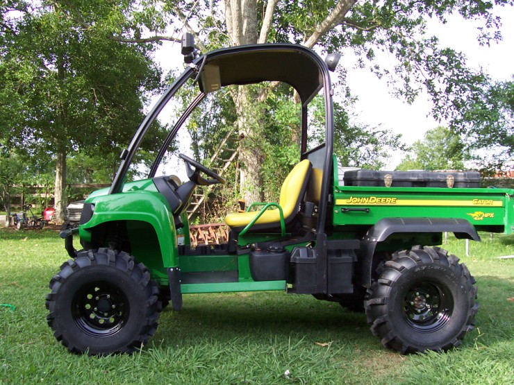

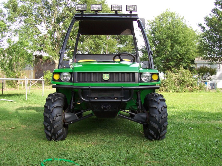

i would go with some 27'' 589's i have them on my gator and now i go through stuff in 2 wheel drive that i used to go through in 4 wheel drive. they have about 1 1/4 of thread and they come oversized (the 27'' in bigger that 27'')

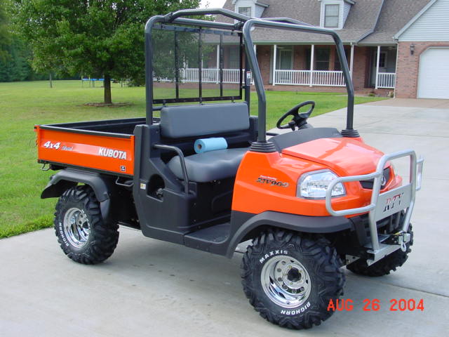

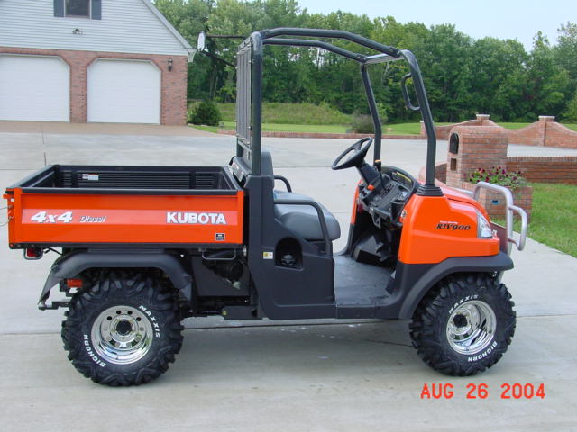

The 2" lift is easy to install and I like mine. You must live somewhat close to me if you're in SW IN. You'd be welcome to see mine and see what it looks like and how it drives with the Bighorns on it if you like. Attached is a couple of pictures of my RTV with the 25" Bighorns and chrome wheels but before the 2" lift. You can see that they are a bit close without a lift, but they didn't rub.
