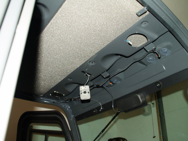

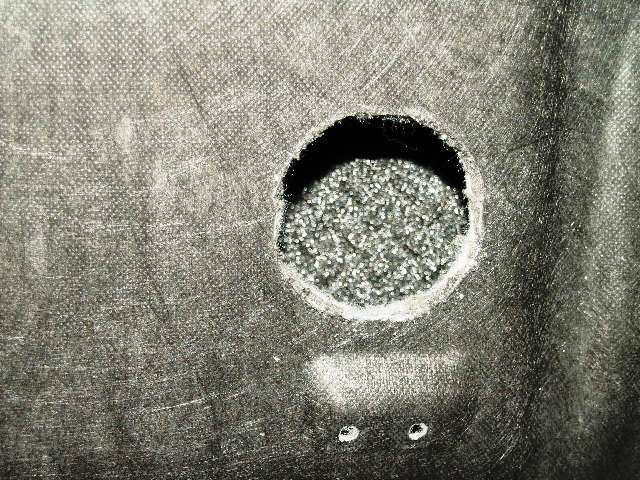

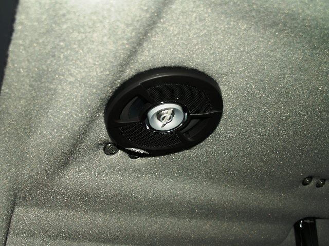

I have looked all over the net for any information on the factory speakers in the Kubota RTV1100 but have found nothing and I have seen several post on here from folks asking about replacing them so I thought I would post pictures and some information as I replaced mine this evening.
This is what it looks like with the headliner removed.
attachment.php
attachment.php

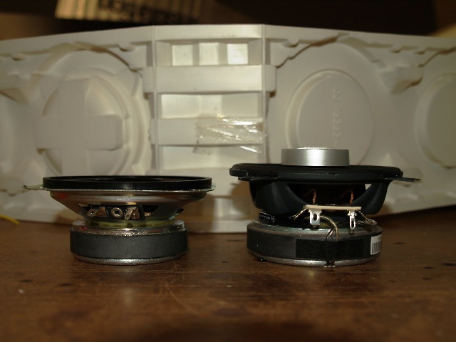

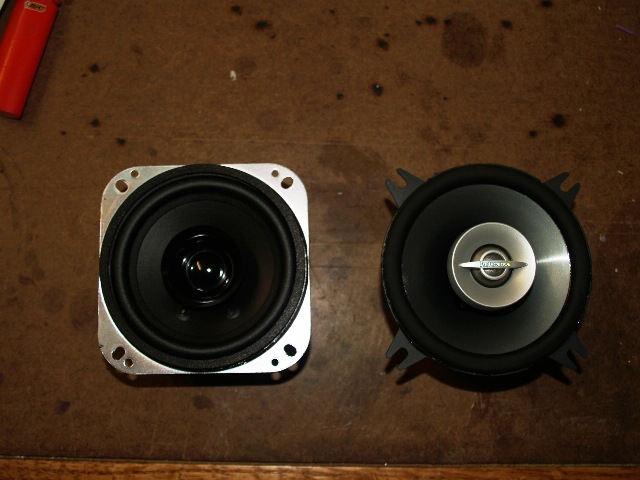

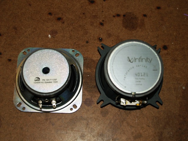

The factory speakers aren't bad for OEM, 4 1\2" poly cone, rubber surround and a decent magnet structure, I had a pair of Infinity 4 1\2" 4012i Reference speakers laying around from my old car audio days which were a perfect fit so I used them, you can see the difference in the factory speakers and the replacements below.
attachment.php
attachment.php
attachment.php

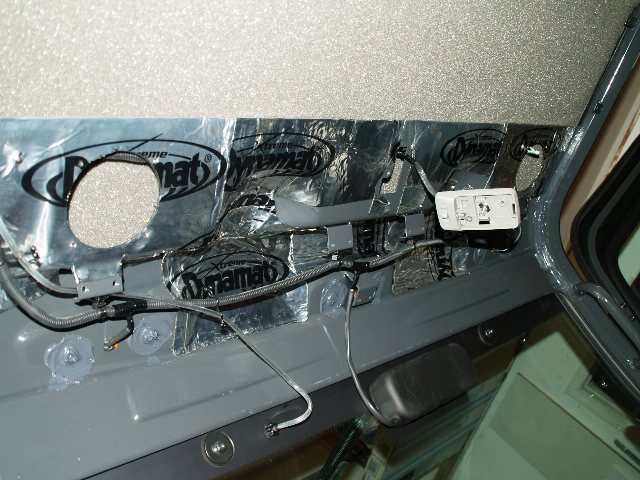

I also had some Dynamat from the old days so I added a layer to the speaker area.
attachment.php

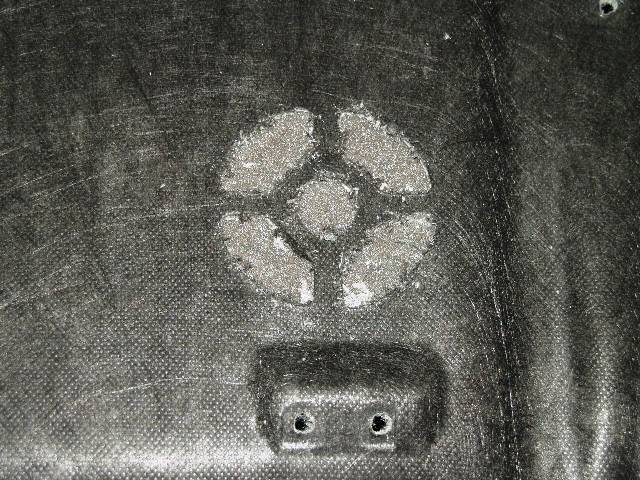

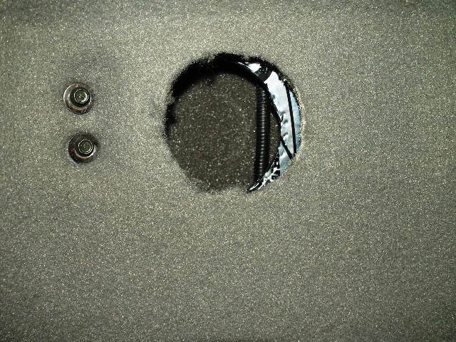

Part of the problem with the sound of the factory speakers is that the foam and carpet on the headliner is not very acoustically transparent even with the plastic part cut out as you can see below.
attachment.php
Since my new speakers are designed to be surface mounted I cut out the section of foam and carpet.
attachment.php

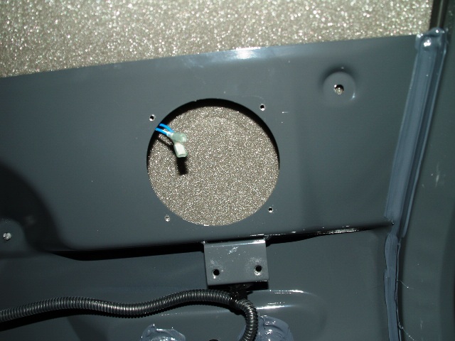

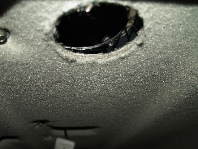

All was going well and it's time to reinstall the headliner and I find that the cutouts in the headliner are not lined up with the speaker mounting holes so part of the factory speaker was not even firing through the cut out.
attachment.php
Then the next problem I discovered is that there is about a 1\2" gap between the headliner and speaker mounting plate, I should have done some measuring before I cut the headliner... so learn from my mistake, no big deal but I would have cut the hole in the headliner differently had I realized this.
attachment.php
Since I did not want to deform the headliner that much I cut a 1\2" spacer out of plywood and mounted it to the headliner
attachment.php

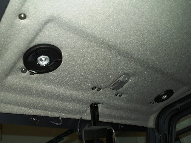

I drilled holes through the plywood and into the steel speaker mounting plates and secured the speakers with 1" sheet metal screws.
attachment.php
attachment.php
The new speakers sound MUCH better that the factory speakers and aren't "muffled" like the factory speakers trying to fire through the foam and carpet of the headliner.
As I stated above the speakers are 4 1\2", you could fit 5 1\4" speakers if you wanted to cut some metal in the steel mounting plate, this is not sheet metal, it's steel and around 1\16" thick and could be cut with a jig saw or nibbler.
If you don't want to cut the headliner and keep the speakers hidden the install would be as simple as removing 4 screws on each speaker and replacing them, while the headliner is out I would try to remove some more of the foam backing so the headliner wouldn't muffle the sound so much and since the factory cutouts are not even lined up with the speaker, it has the same effect as throwing a towel over the speaker :D

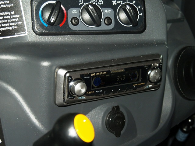

My radio is a Pioneer DEH-P3600 also left over from my old car audio days, I'm very happy with the way it turned out and I hope you find this information helpful if you are thinking about replacing you factory speakers.

Thanks for the writeup and pictures. I've been kind of hesitant about replacing the speakers but your writeup makes the job sound easier. Have you ever thought about putting a amplified subwoofer in as well ?
Thanks
Randy
   / RTV1100 Speaker Replacement with Pictures
Thanks
Randy
Randy,
Yes, as a matter of fact I was looking at this last night :D
IF I do it I will build some sort of small enclosure to hide somewhere.
probably fabricate something out of fiberglass, I was looking around last night and I have some small 5" subwoofers left over from my car audio competition days that were pretty impressive for their size, I may try to do something like this later on when I get some time.
I also thought about building something with an 8" sub and making it a center console with cup holders, storage, etc.
I'm sure I won't be able to leave it alone for long :) I'll post if I decide to build something.

Thanks for the info on the speakers Steve..That's on my to-do list..Now that I know the speaker size, i can do it all at one time...thanks
So the sound is materially better? In other words, the effort pays off?
Tim,
YES, MUCH better, well worth the effort!!
   / RTV1100 Speaker Replacement with Pictures #6
Tim,
Thanks...Will pick up something that I can find retail..JBL/Polk..Whatever at 4.5"
A bigger help than you know...Thanks Dude!!!
