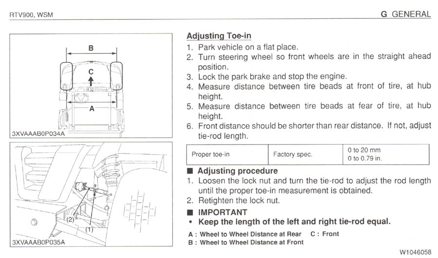

The book calls for The toe in to be adjusted at 100 hours mine has not been I have 149 on my machine and as I mentioned in a previous post the tires were wearing twice as fast on the front as the back so I rotated them, just wondered if I needed to adjust toe in and is it something an average owner could do, I am no mechanic.
   / RTV Toe in adjustment? Aybody done it? #2
Here's the procedure for toe-in adjustment from the workshop manual.

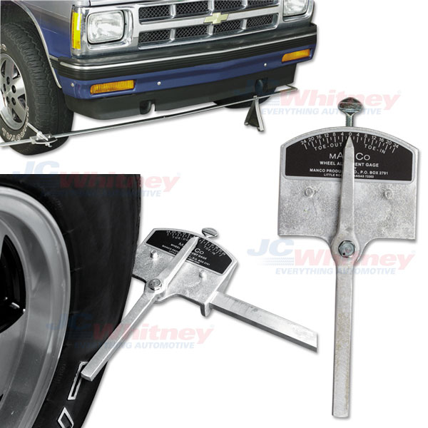

From J. C. Whitney - item #ZX192207Y
About $54 with shipping.
Edit - Harbor Freight has this for only $12.99 plus $7.00 shipping - item #30167-4VGA
   / RTV Toe in adjustment? Aybody done it? #4
Here's directions for the toe-in tool from Harbor Freight.
  • 30167.pdf
