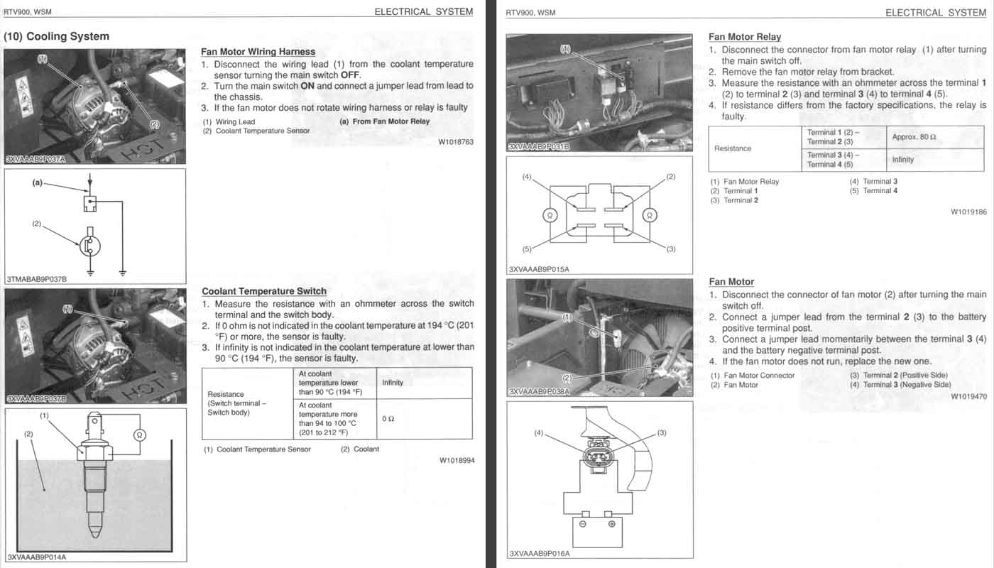

Anyone know of a way to test it without running up to temp?
   / RTV Cooling Problem #7
Here's the two pages covering the testing of the fan in the workshop manual.
Hope it's not crunched down too much to be legible.

lloyd123,
Thanks for the Workshop Manual pages. I did notice a discrepancy in the manual, however. The relay shown as the "fan motor relay" in the Workshop manual is labeled as the "relay starter" in the RTV Parts Manual. The smaller one on the very end is actually the one that controls the fan on my RTV and is the one that was unplugged. It is simply labeled "Relay" in the Parts Manual. This is why I checked this particular relay. I have no shop manual, so I studied the parts manual and concluded that this was likely the fan motor relay. I checked it and discovered it was unplugged.
I wonder why the discrepancy? The relay that was unplugged on mine seemed to affect nothing but the fan. Oh well.
I just wanted to mention this in case anyone else ever has the problem I had. The procedure in the shop manual would not have led me to my problem, unless I happened to notice the unplugged relay next to the one indicated in the procedure.
