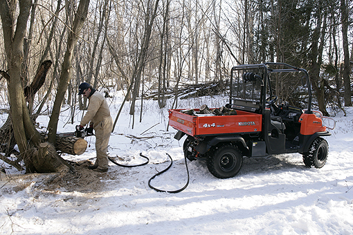

Anybody knows what is the box in the left side of the photo? The box is located on the right side of the RTV below the bed. We can see also this box on the Kubota web site photo's section.
Kubota Tractor Corporation | Utilty Vehicle RTV900
My guest is this box is related with the hydraulic tools but I can't see part no or info.
Give me your opinion!

It's the Hyd. Resevoir for the power dump and power tools.
   / RTV 900 1 million $ question #3
i was about to say thats what it was . there are no signs of it being a batter box plus the way he's runnin that saw it would need alot of fluid just to fill the hose. some people might think that you can just connect anything to a hydr pump and it's good to go but thats not true if you have a long hose or fatter hose you need more fluid so the bigger the reserve tank the better.

I think the same about the tools oil requirement but I can found any part# for this tank on the Kubota web site?
I see the new model of the 900 include the tank with the utility valve but mine as the utility valve without the tank? What I gone do?

Ya but I purchase it from the original owner... I need to find out if I can upgrade my model or may be I don't need it because the utility valve is connected to the bed lift tank on my version of the Turf RTV.
   / RTV 900 1 million $ question #10
That utility valve you have it for low flow demand hydraulic like a quick attach blade, sweeper or hydraulic bed dump.
You aren't missing pieces,.. that is how that unit comes.
