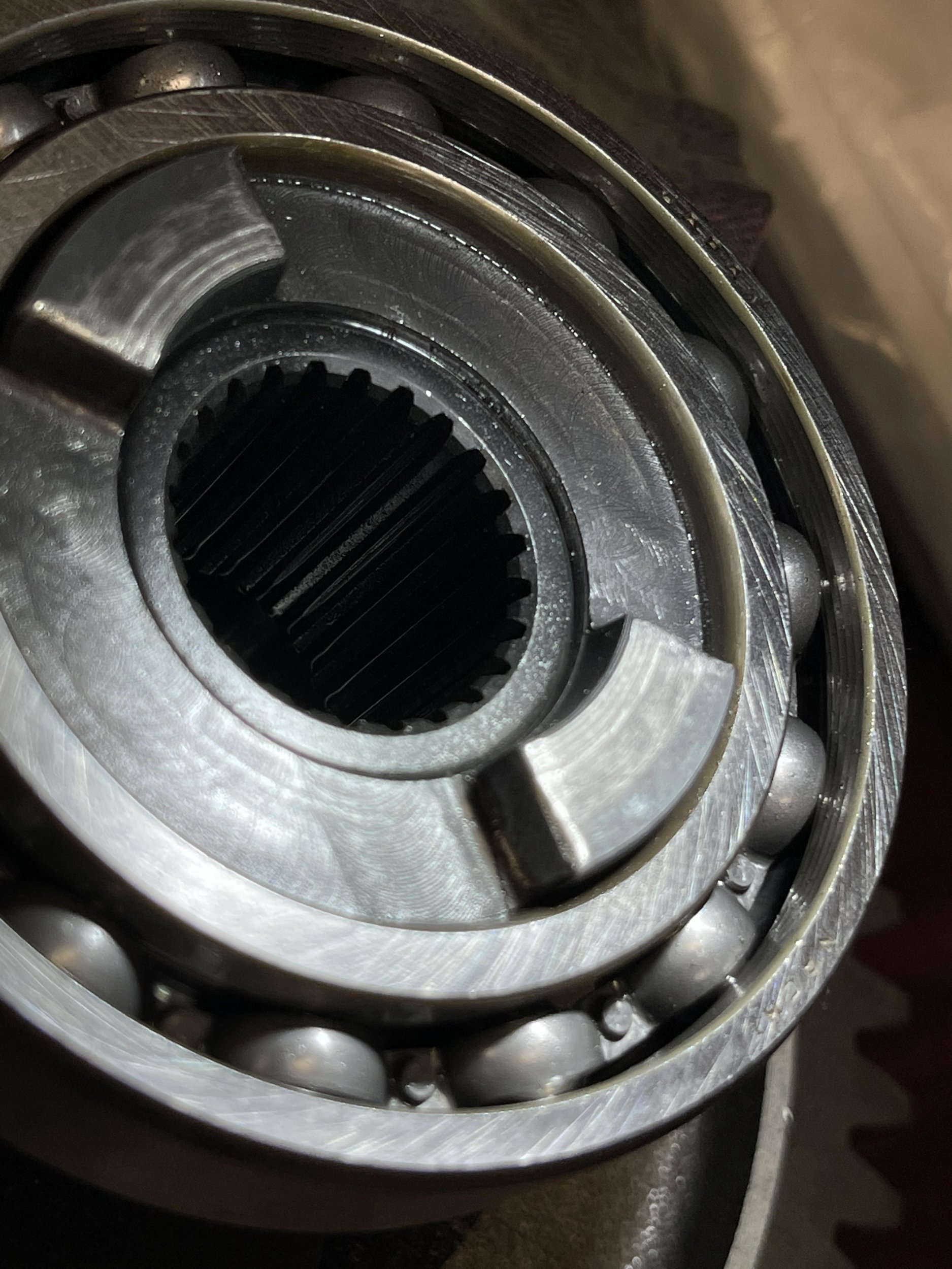

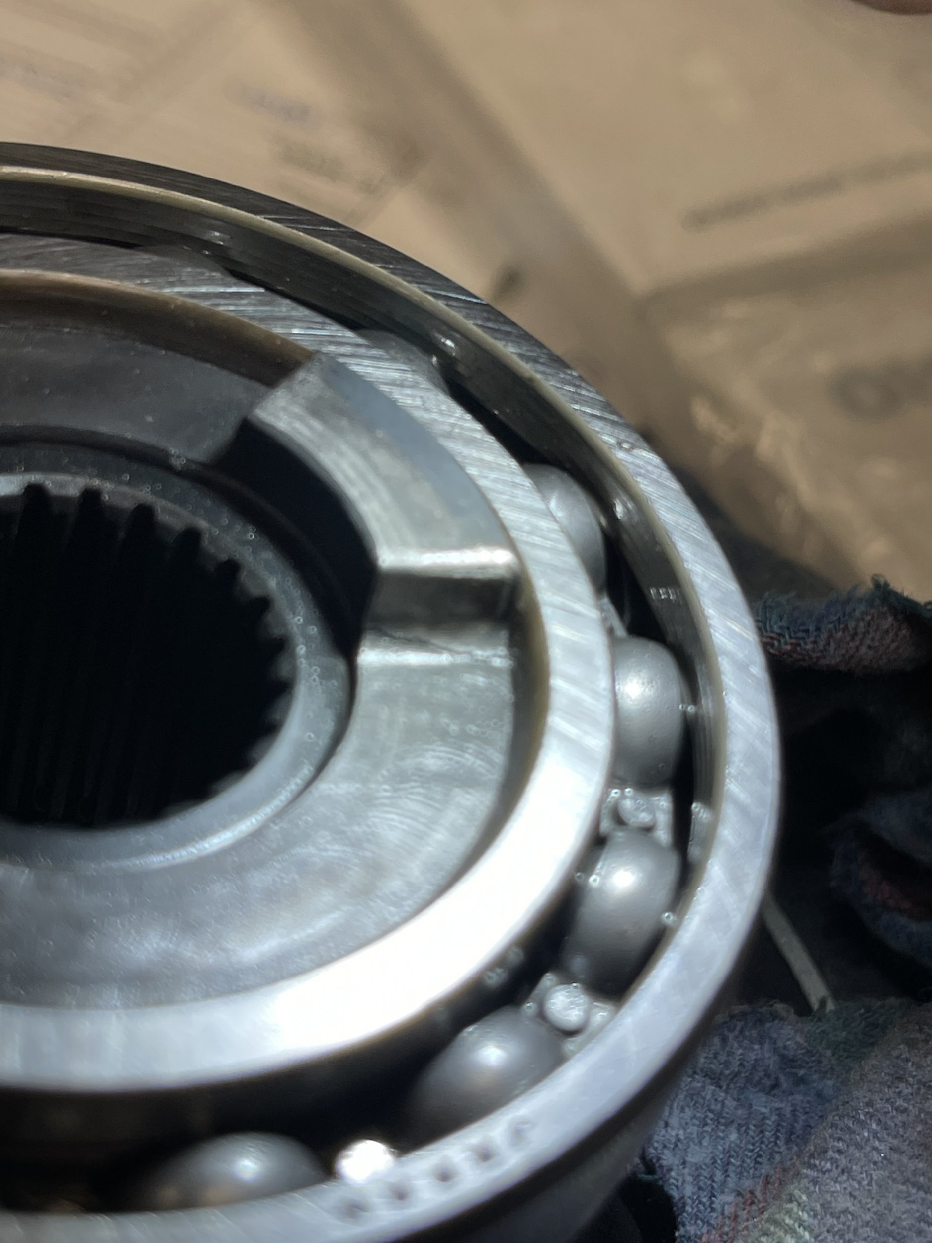

I requested to inspect the components to see why why had ruled it operator abuse. Upon very close inspection with a bright light there was a hairline crack in the casting at the corner of both locker contacts. The surface of the contact was also polished and probably had a coupler thou wear. Yes you would litterally need a microscope or micrometer and a good part to compare any measurable wear.

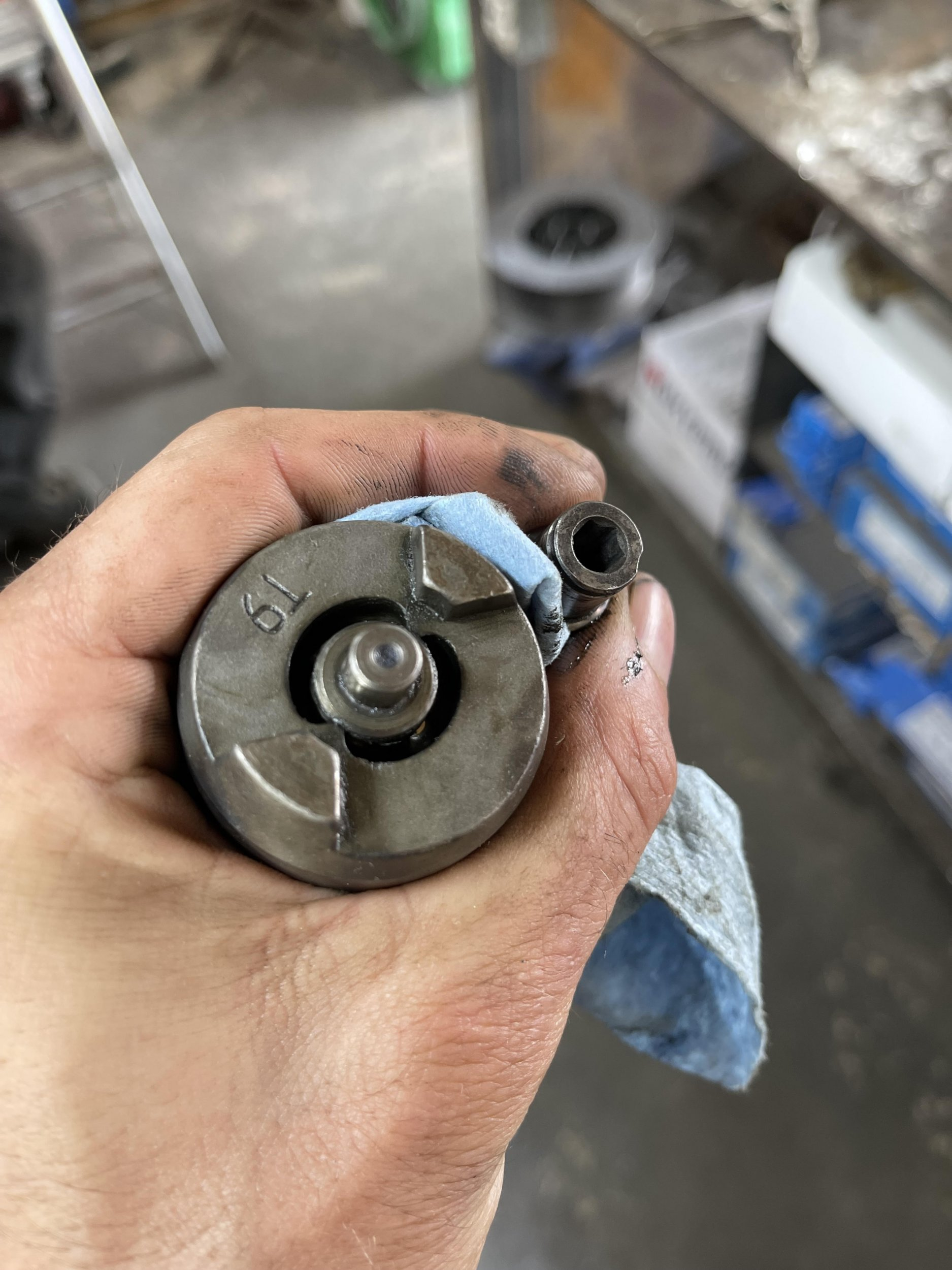

All 3 units have non functioning diff locks. So far we have opened two units. the first had two hairline cracks and some slight wear on the forward face of the contact carrier side. The second unit the contact lugs were ripped clean off.

This is a photo of my first unit. notice the the lugs are intact and there is some wear on the forward face and no wear on the reverse face. In this example the only conclusion that can be drawn is that the locker would have slightly reduced function in forward and little to zero reduced function in reverse. That is unless this is a fundamentally flawed design. Now notice the size of the lugs they cover approximately 30% of the face. The other coupling covers the other 30% this leaves 40% free space to slide back and forth when starting stopping turning left right etc. So as you drive with this engaged its going to constantly be hammering back and forth. Then if the hit is hard the spring will depress and the hammer will skip over and slam in on the next 1/2 revolution.

As you can see by the patent this design is known as an "impact clutch" they are most commonly found in impact drills like the above pictured dewalt 18v impact screw gun. The mechanism rotates and after every impact the spring depresses allowing the hammer to skip over to the next lug. Note the spring used on the dewalt is several times stronger than the kubota spring. It takes two strong hands full power to depress it enough to get the hammer to slide over. Now notice in the patents one of the most critical components of making this design last for millions of stikes is the metallurgy and case hardening of the parts. This usually involves machining or forging the parts rather than casting and then blasting them with tiny ball bearings to harden the surface. Notice the tiny orange peel texture on the opposite cam of the kubota aswell as the two cams for the 4wd clutch. This is why taking the parts in for a rockwell hardness test.

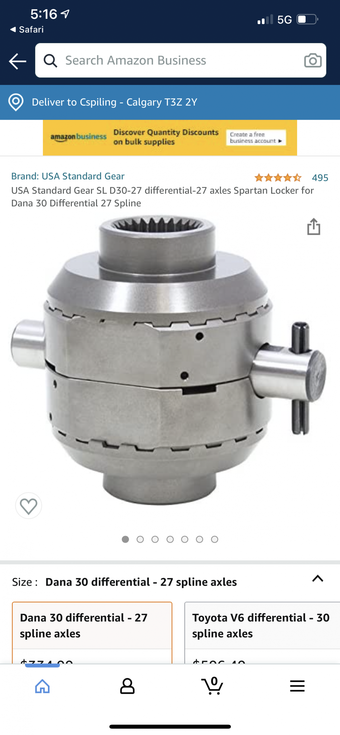

now this picture is the industry standard for face contact differential lockers. notice the contact lobes or teeth do not allow any play. if the force overcomes the holding capacity of the locker the springs allow the coupler to slip then grab again once the two axles come back to a similar speed. These lockers as pictured usually come with lifetime warranty. Note if the wheel does break free it will accelerate then there is potential of this locking at high speed. The manufacturer anticipates this and ensures the parts are strong enough to hold up under any possible situation.
