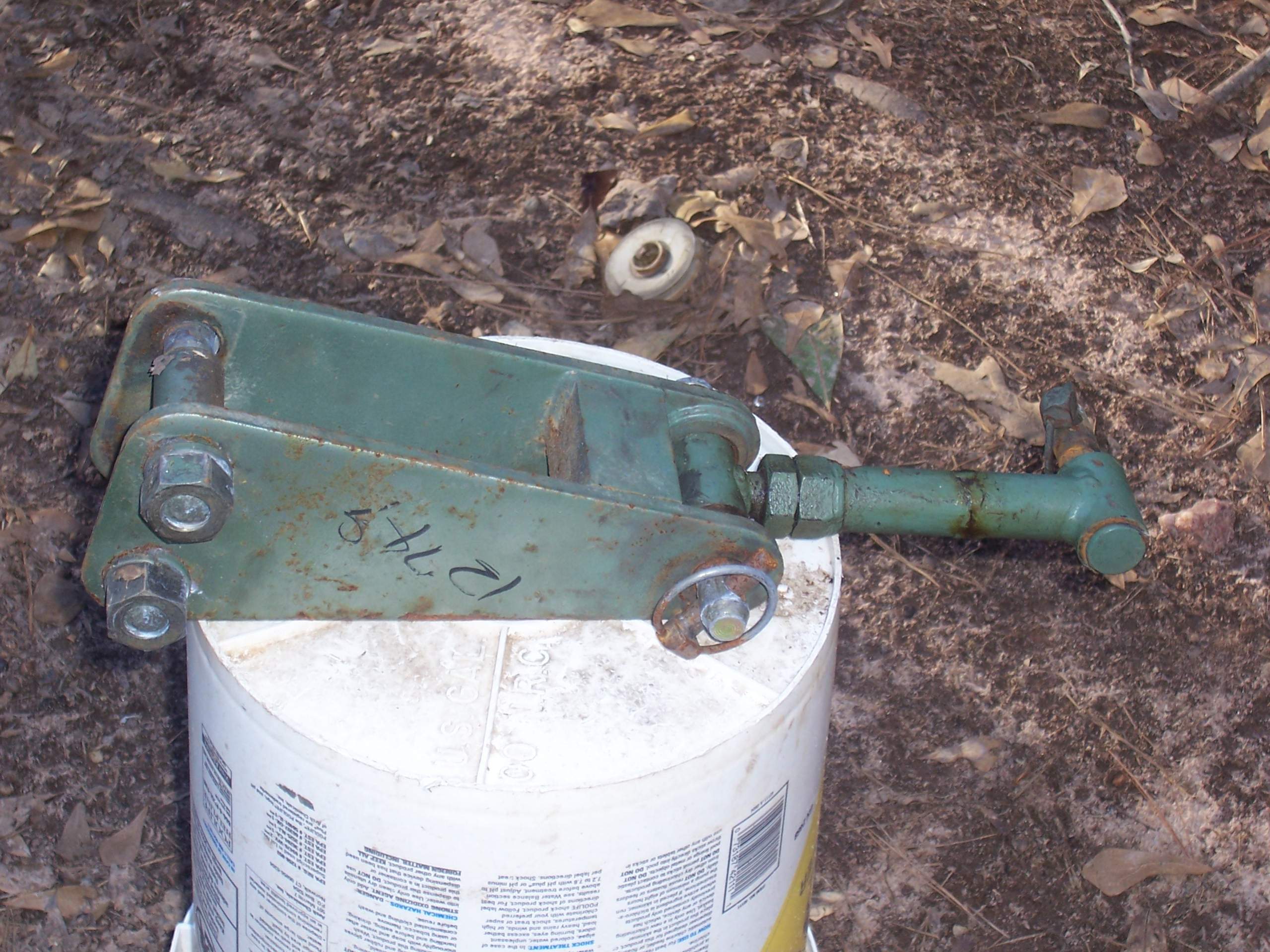

The top link should have came with the tiller. It is a two part system , that bends in the middle.
   / RS1303 Tiller Question #5
Thats Good Monte glad your got it going :D

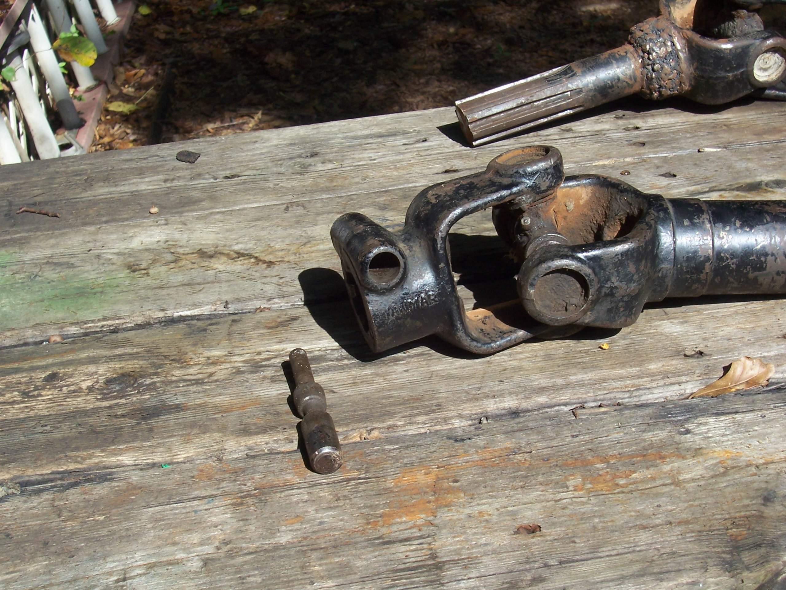

Here is a pick of the top link for a RS1400 the 1303 should be similar or the same. I'm getting better but now you put me on it and I stated I had the same problem now I remember why. They gave me the wrong PTO shaft and I couldn't shorten it enough. I actually had to shorten the top link also to keep it from binding.Look at the top link at weld.And also PTO welding and cutting. Like I said I had the same problem with binding.And something else reminded me as my name just came up. The real bad part was The tiller was stock for my tractor and came from a ( UH TA DA ) there you go dealer. I hope there ROP's fit better than thier implements do.Hate to be on that truck route :(
Carey
