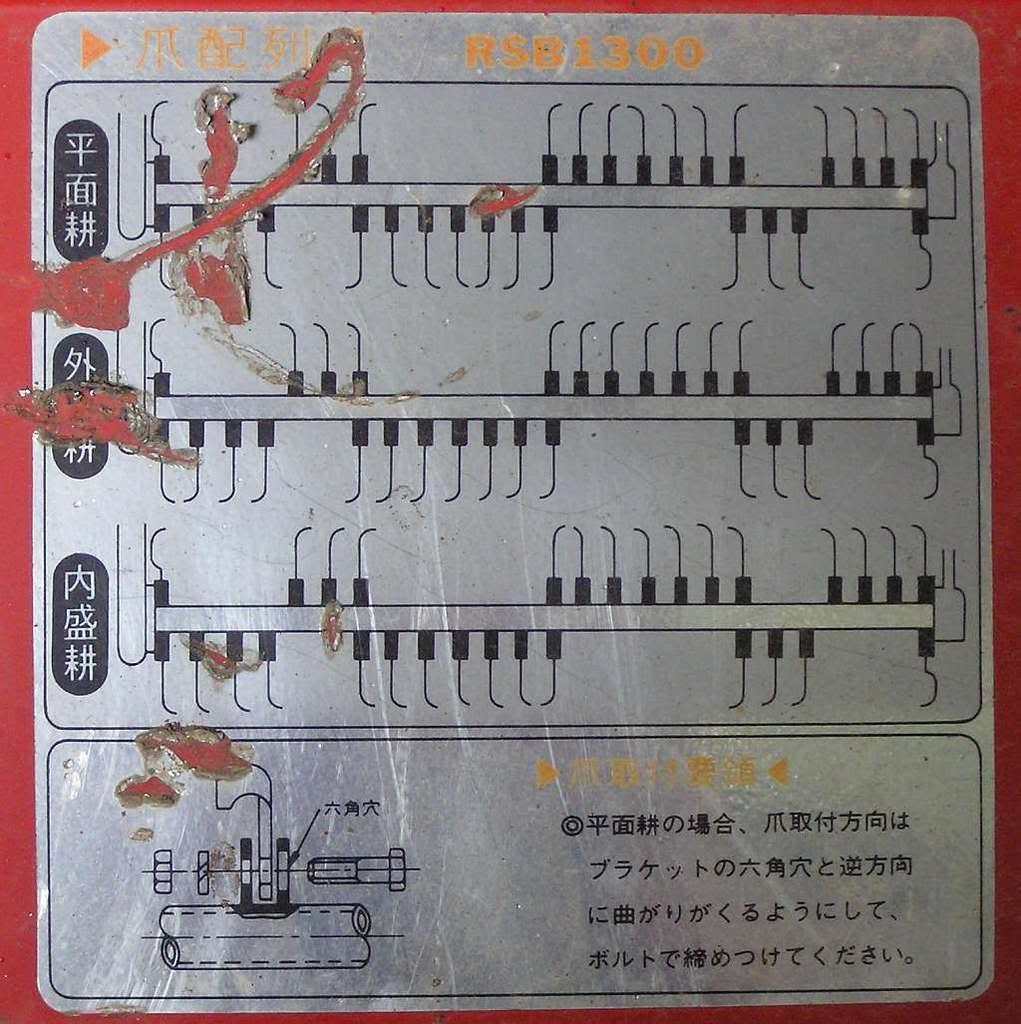

my father has a rs1200 tiller for his 1500 yanmar.he bought new tines but the decal on the tiller has worn off and he's not positive he has them all going the right way or not.ever since he has changed them out they dig in and its all that the tractor can do to pull it.if anyone knows where i can get a new decal are tell me what the decal says it would be greatly appreciated

I have a picture that I got from someone here on the forum of the picture on a YM tiller that might be what you need. I do not understand it, but maybe you can make sense of it.
It should give you the tine patterns and should help solve the problem even though it is for an RS 1300.
Mike
   / rs1200 tiller? #3
I put new tines on my 1200 last year but took them off one at a time and replaced each one to get them back on in the same pattern. My 1500 has no trouble pulling it. Made an enormous difference in depth of tilling but the old ones were really worn.
