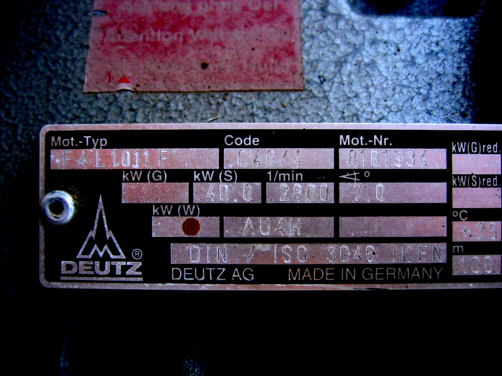

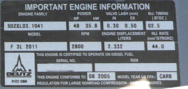

Dear Carl,
I don't know if this helps, but on the 2011 series engines, there is a plate on the engine that lists its specs. Actually, mine has two; one in english and one in german. The german label has a little more information on it. I have attached a photo below.
My BF3L2011 has a 2800 rpm limit.
The Deutz specification sheets for the 2011 series show that the engine is nearly linear in power output to the redline number.
Just as an aside, fuel efficiency peaks at about 2100rpm, but it is a pretty flat curve.
In general, agricultural machinery are under enough stress from the pulsation(shocks) and the dirt that trying to push the redline tends to rapidly degrade engine life. At the same time, the engines are designed to run every day, all day.
All the best,
Peter

   / RPM's anyone?
Peter just sent me some info directly, and it states the motor is rated at 2800 RPM... Terry said 3K... Ohhhwell... Make me no never mind...
   / RPM's anyone? #4
So Carl,
What does the name plate on your motor say?
We're curious...
All the best,
Peter
