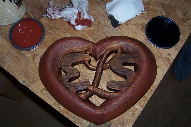

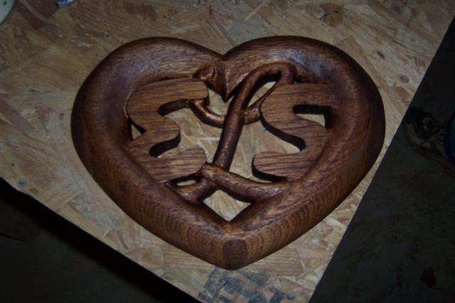

One trick that I like to do is to stain the entire piece of wood a light, or neutral color that you like. Then I use dip a cloth into paint very lightly and rub it into the stain after it's dried. The paint is thin enough that it doesn't cover very well, but does change the color of the stain. More paint, more of a change.
The pictures are of a carving I made for my wife on Valentines. I stained it with Minwax in a color called Early American. Then I used a very small amount of red paint, and rubbed it into the stain. The color is subtle, but noticable. More paint would have made it more so.
