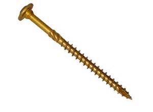

When using round poles, how do you splice the purlins? Thinking that there isn't enough area on the round to butt them. Local sawmill Pal says he will cut one side to have a flat surface, however he hates cutting old utility poles. Is it worth the trouble or am I over thinking this? :confused3:

Chances are that the pole(s) are tapered, and close to the bottom there will be enough room for a few good GRK screws for the butt splice. As is tapers, I've done a little notching to allow for an additional 2' or so "backer" 2X under the splice while adjusting for a true wall trying to take out the taper. With utility poles, it's hard to make a perfect wall.
