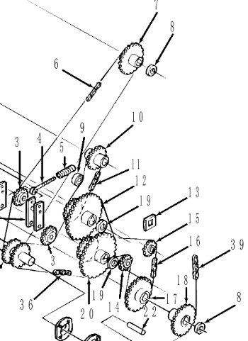

One chain is RC60 @ 142 links, another chain is RC60 # 102 links, RC50 @ 57 links, RC2050 @ 50 links. I'm not familiar with NH round balers to know if there are more chains. Chains can be purchased at several places such as TSC, Atwoods, Surplus Center, Grainger, Bomgaars or other businesses that sell agriculture repair items.

Perfect, thank you! I've seen that diagram somewhere, damned if I could find it again!
