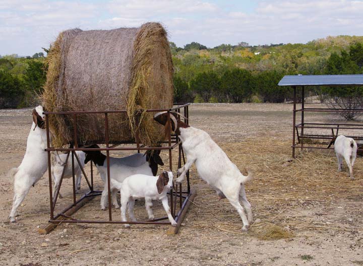

If you raise goats then you know that feeding round bales of anything is a waste of money. They love to get on top of the bale to do their business, urinate and defecate, then they won't eat anymore of the round bale.

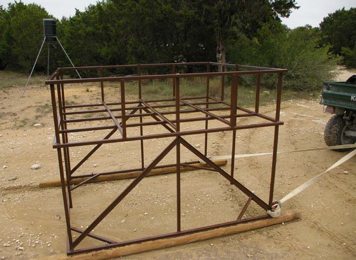

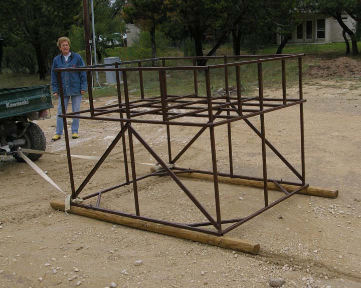

Well, I may have found the solution to the problem. A friend told me about a stand he had built on which he set his round bales. He cut his waste by 75% and his goats build up their hindquarters since they have to stand on their hind legs to reach the hay.
He invited me over to take a look. I took some pics and then went home to build my own. The pics are of my project. To avoid rust by placing the rack directly on the ground, I bolted it to a couple of landscape timbers. The timbers also act as skids to move it around, without a bale on it, of course. It can be towed by my Kawasaki Mule with no problem.
Project cost was about what you would pay for a hay ring from TSC not including labor because "welding is fun". :D

I would LOVE to build one of these goat round bale feeders you posted pics of. I can get the general design from the pics, but can you tell me what size/guage metal to use? Also what is the overall dimensions and height of the "tray" that holds the bale? We generally use 4X5 or 5X5 round bales that I'm guessing weigh up to 1200 lbs.

I used 1 inch square x .120" steel tube. It is built 60" x 72" on the sides by 52" high, the bale platform sits 36" up from the bottom.
It is very easy to build. I started by first building the three 60" x 72" base, platform and top rail pieces. From that point on it was really simple.
The bale sitting on it is a 4 x 5 and I'm guessing maybe 800 pounds.
Let us see how yours turns out.
BTW, if you haven't bought steel lately, be prepared for a shock.:eek:
