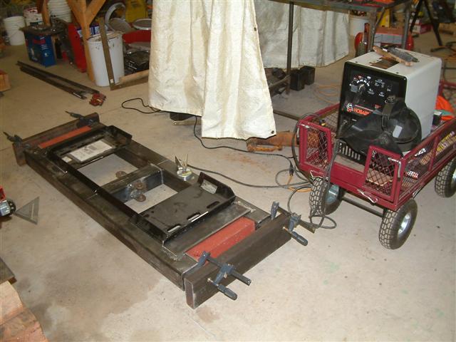

I bought an old manure bucket and now I need a universal SS plate put on it. No modifications for the bucket needed, just cleaning the surfaces and clamping the two together and welding them up.
Is an hour a reasonable amount of time to do this for a shop to do? Seems like a reasonable minumum charge even if it takes a 1/2 hour. How many feet an hour can a pro welder do of bead on mild steel?
   / Rough estimate to put a SS QA plate on a bucket? #4
About an hour. That's the time it took me to weld one of those SS/QA plates onto the frame of a bale squeeze I built a few years ago.
   / Rough estimate to put a SS QA plate on a bucket? #5

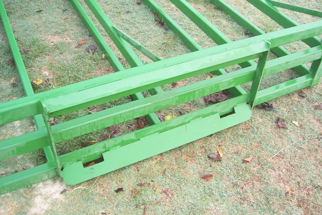

I don't buy the plates anymore ... takes a couple hours to cut one out and weld it up.
Here's the one I put on my accumulator when I built it.
   / Rough estimate to put a SS QA plate on a bucket? #8
Nice work. I like that accumulator design :thumbsup:
