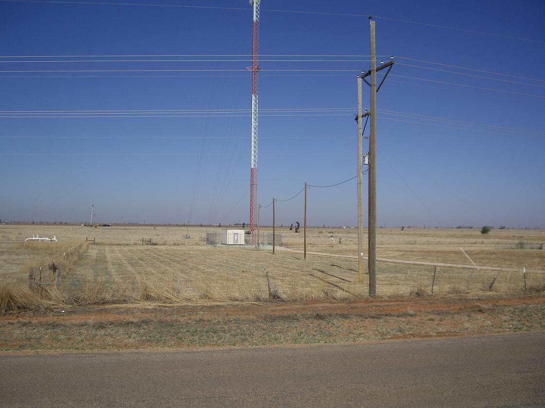

All that being said, regardless of what I do, (tilling, plowing, shredding) I charge $50 per hour with a two hour minimum and that includes my travel time to and from the job. I've never had anybody squawk about what I charge. Maybe I don't charge enough but what ever...I get to work a bit and earn a bit of cash.
Now on the odd side of this, I've had people pay me more than I was going to charge.
These pictures are of a job I did this weekend and the guy paid me more than I charged and now I have a continuing job for this site.
(qualifier) I do cut certain folks some slack on what I charge. Little old ladies, single mothers, friends who can return a favor, you know, stuff like that. But I get nothing other than the satisfaction of knowing that I helped someone who could not have gotten the work done otherwise. That means a lot to me.
PS,
If you're going to till an acre with a 5 footer, you're gonna be there awhile. :)
