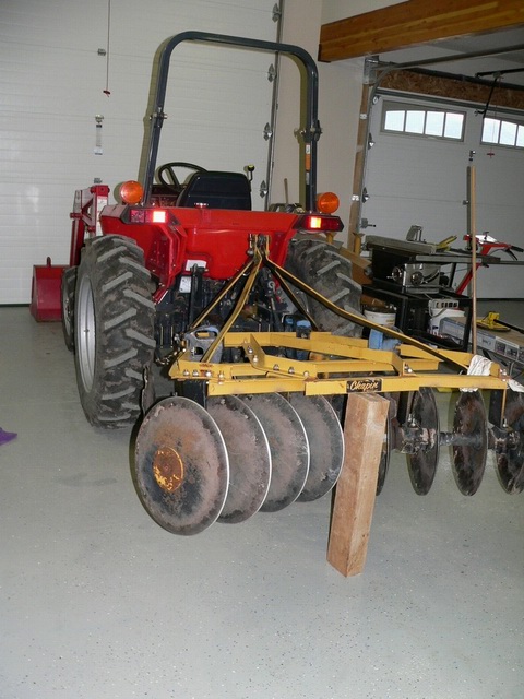

Funny this thread came up when it did as I had the same delima. In my case I already had a 5' disk, although I never had used it since buying it used a few years ago. Anyways, after freeing up the bearings and tightening the thing up, I figured I'd give it a try before making the $1500 purchase for a 5' tiller. To my great delight it worked very well, BUT, the soil at our new place is 100% rock free. I think thats the big clincher, no rocks. I remember as a kid in upstate NY using s drawbar disk behind a Farmall H and having that thing just bounce over the rocky fields, even after being plowed it was rough going. I do have areas of thick sod though and that presents a problem requiring many passes, still overall I am pleased and will not buy the tiller, although I understand the benefits. I've found myself using that disk a lot in the past few weeks for many different tasks, smoothing out clumps over backfilled ditches has worked out really well.
