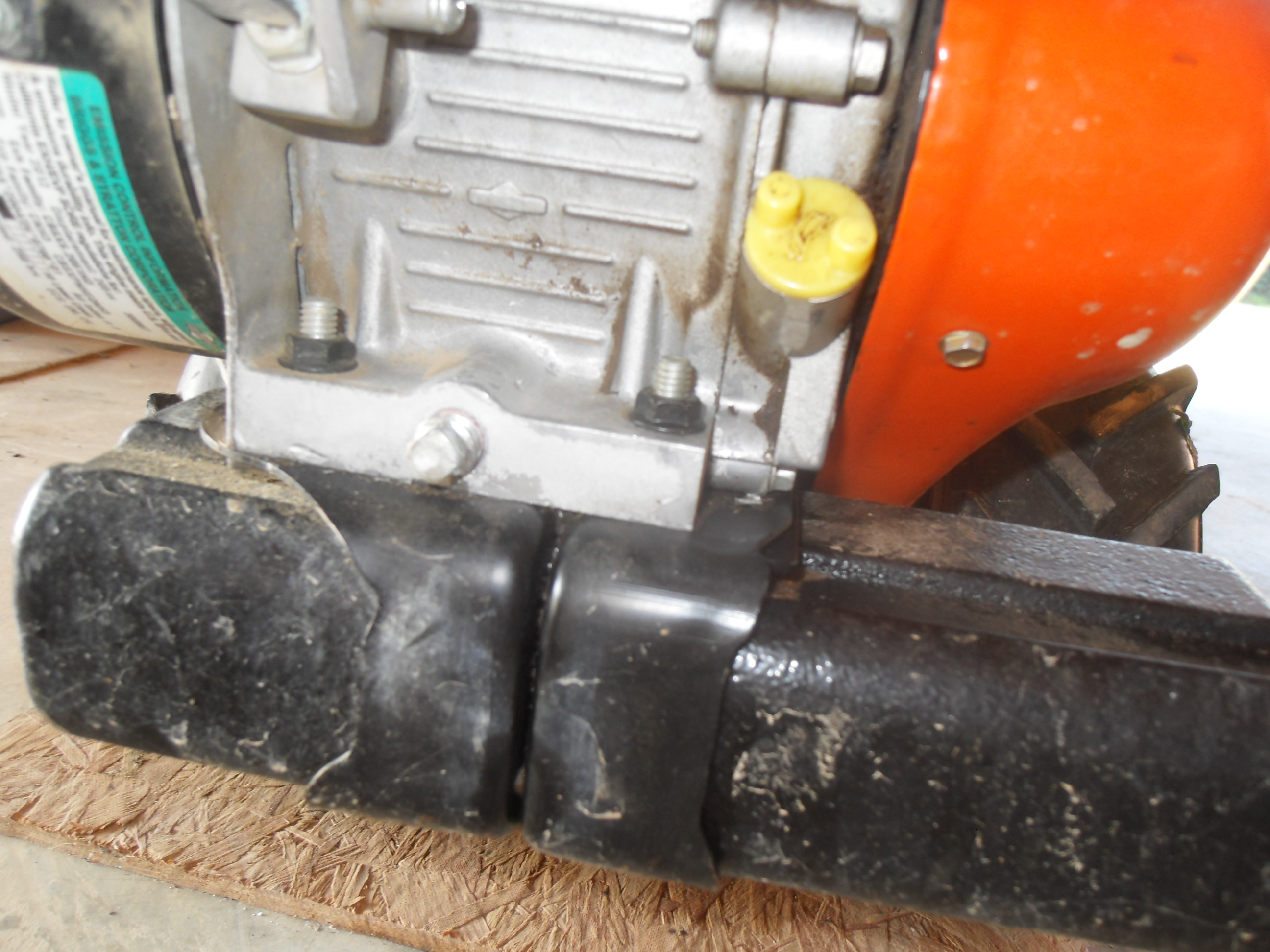

Started tiller up, oil came out everywhere. Repairman said I just put too much oil in and changed the air filter(which was covered in oil) and cleaned it up. I asked him which was the correct place to check and fill the oil, even he was a bit baffled as there were three oil caps, 2 orange and one white. Can anyone give me some direction as to why there are three oil caps and which one is the correct one? The one in front has an oil drain plug near it, but that may be deceiving. The manual offers no help.

There are three oil input plugs because the engine can be used in different equipment applications. Any one of them should be good for checking the engine oil level or adding oil as needed. You can use the one that is most accessible. Other TBN'er can correct me if I'm wrong.
I don't think any of the three are for gear oil.
