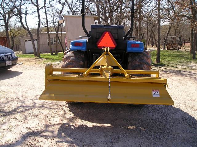

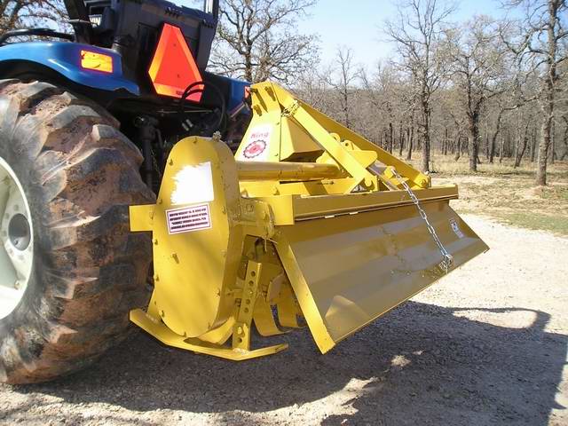

   / Rotary tiller on TC45 #5
KingKutter II, 72" is my suggestion added to the "pile." Anything less and you'll be disappointed. I L-U-V my tiller.:)

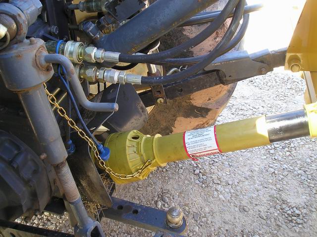

From your pictures it looks like a piston for downpressure is rigged, do you have 1 or 2 remotes rigged as well?
