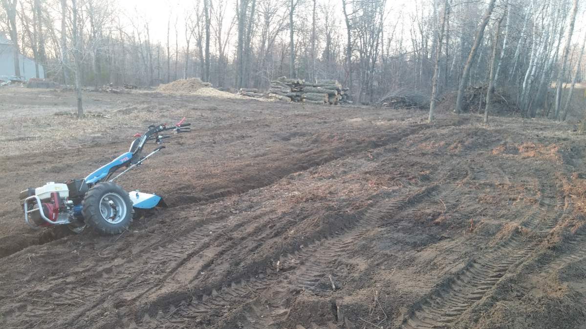

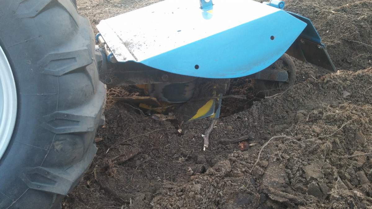

The berta will dig a 10-12in trench in one pass and you could do 18in if you made three passes laid your pipe and then back filled the trench but you would have a good pile of dirt. I'll be using mine for that in a couple weeks. Also it will dig at about 1mph and I can run my honda gx390 at about 2000rpm or less and it still just chugs through the soil. Just does it slower. Here is a couple pics of my machine. Hope it gives you an idea. I can't help you on adapting it to your machine though.
